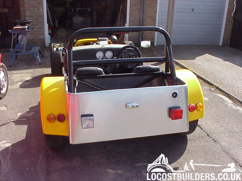

Mine is a clear LED one from SVC and cost £20 from the Donny show. See pic below.
Howlor
posted on 28/11/05 at 01:45 PM Reply With Quote
posted on 28/11/05 at 01:52 PM Reply With Quote
Mine's a cheap & cheerful one I got from a local motor factors - cost me around £10. I threaded a wire through the roll bar. Personally, I'd want one a bit higher than Howlor's - mine's slung unter the top bar.

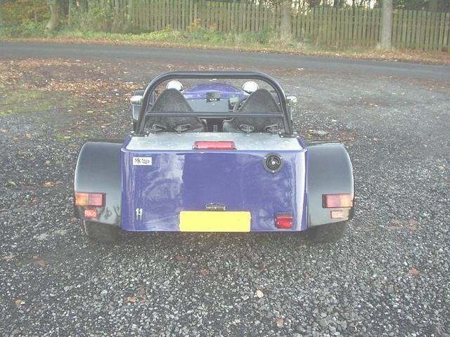

Here's mine - you can just see it under the top rail.
Rear view
(I didn't post it up here as it's a bit large)
It's a small light, but VERY bright.
