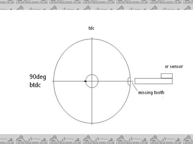

hi all i am at the stage where i need to mount the trig wheel and vr sensor. i have come up with this picture as a picture is more clearer than me
trying to say what i mean.
so can anyone help is this the correct position i should have my trig wheel. i have put the vr sensor on the exhaut side of my 4age, so it is 90deg
after tdc, the missing tooth is at the bottom, which is opposite tdc.
if this is incorrect please correct me as i am not sure on this one,
thanks
rob

graememk
| posted on 18/5/06 at 09:46 PM |
i thought it was 90 before tdc? well mine is and it works.
i put mu engine at 90 deg before tdc then removed the tooth under the sensor
COREdevelopments
| posted on 18/5/06 at 09:49 PM |
my vr sensor is after tdc as it has no room on the otherside. i need to know if this is correct if not i need to be corrected as i dont wanna screw
things up.
anyone ??
COREdevelopments
| posted on 18/5/06 at 09:59 PM |
this is what it would look like when the missing tooth is aligned with the crank sensor. does this help???

graememk
| posted on 18/5/06 at 10:04 PM |
thats how mine is as long as the car is at 90 before you can have the sensor anywhere as long as the missing tooth is under it
COREdevelopments
| posted on 18/5/06 at 10:08 PM |
thats what i thought but was just making sure as i never done this before so just want some reassurance, thanks for your help though. also im now an

paulf
That is correct , the missing tooth needs to align with the sensor 90 deg before TDC which is how you have it. It does not matter where the sensor is
as long as the relationship is correct.
