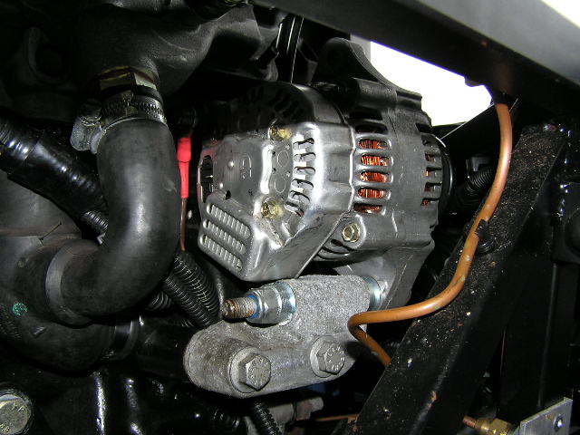

now i have batteries here are the pics:
  alternator location
  alternator location again
beware, I've got yellow skin
DIY Si
| posted on 19/6/06 at 10:08 PM |
That shouldn't get that hot there. I was expecting it to be much closer than that.
ned
| posted on 20/6/06 at 07:27 AM |
at the closest point its probably about 2" from the front exhausts header. I think I will wrap the exhaust anyway as the water outlet and
thermostat is very close as the exhaust curves towards them to get the lengths equal.
Ned.

James
| posted on 21/6/06 at 09:47 AM |
Mate,
You sure it's the heat that's killed it? Not just some dodgy wiring or 12v ignition feed or something?
From what I saw last week it looked more than far enough away... it's certainly further than mine!
