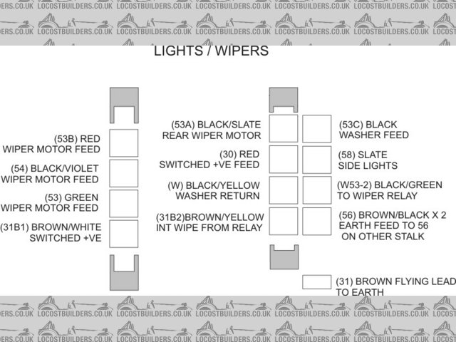

Hi ya , i have a standard ford sierra indicator stalk with hazzard switch on top , can any one tell me what wire goes where , many thanks

not sure on the loom as i bought the car half done , i know which wire does what on the car it is just the wiring on the stalk
RichieC
| posted on 14/7/06 at 03:20 PM |
Cant remember who originally posted but..........
[Edited on 14/7/06 by RichieC]
RichieC
| posted on 14/7/06 at 03:21 PM |
T'other
davrus
| posted on 14/7/06 at 03:34 PM |
perfect , thanks alot , you have taken a big head ache away
