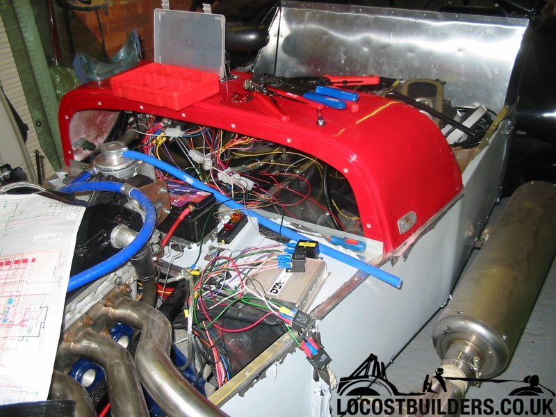

RazMan
| posted on 23/10/06 at 04:08 PM |
Yes indeed - I did make a daisychain from 6mm wire and it is doesn't fit into the moulding very well.
I then tried forming the connectors still on the roll. This was a bit more successful but I have to wonder if the whole thing will handle enough power
as the amount of connection metal is quite small in places

| posted on 23/10/06 at 04:30 PM |
Why not just solder the 6mm to the strip, to beef up the current carrying capacity?
RazMan
| posted on 23/10/06 at 04:56 PM |
quote: Originally posted by CaLviNx
For a wire daisy chain I would remove ALL the sheathing and solder the bare wire and bend the wire neatly into a bus bar
I think that is what I will do as the way the connectors are pressed from the strip, the metal narrows down considerably in places. The wire will
obviously handle it better.
Raz
