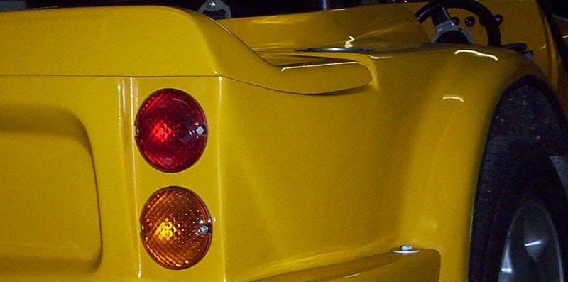

Dumbass Question I know, but can anyone tell me which is the brake light and which is the tail light in this picture. I'd go look for one in the street but you dont see many of either around, and I dont want to wire it up wrong!!
Image deleted by owner
Oh and before anyone say's it I did manage to tell that the yellow light is for the Indicators

Top are indicators...
Middle is reflector...
Bottom is Side and brake light combined.

They are the right ones for the Dutton that he has S3 or S4.
Not from a Bedford the earlier cars used the CF lights - those lights are a large trailer type lights.
The Lower light is not a combined bulb type they are all single filament bulbs
Top is a 21 watt indicator
Middle is a 5 watt side lamp
Bottom is a 21 watt brake lamp
Take all the earths to the stud on the back and the run a connection from the stuc to a chassis earth

Thanks for that, Ill get splicing....
