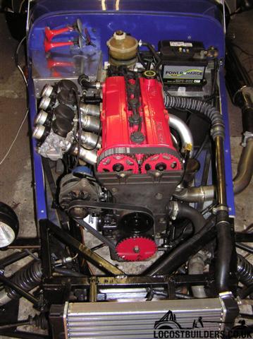

I'm having a problem getting my engine to fire for the first time. Thought it might be the firing order.
Fireblade carbs, Megajolt and 1800 Zetec.
Do the numbers on the coil pack correspond to the firing order
( coil #1 to cylinder #1, coil #3 to clyinder #2, coil #4 to cylinder #3 and coil #2 to cylinder #4)
or the position of the cylinder from the front of the engine
(coil #1 to cylinder #1, coil #2 to cylinder #2 ect)?
Should I fit the leads 1342 or 1234 as numbered on the coil?
Confused.

Took the rocker cover off and checked the valve timing. Looks like I set the trigger wheel 180 degrees out.
Swapped the ignition leads about, put a squirt of petrol into the carbs, added a dash of easy start for flavour and it burst into life first turn.
Should have known that the trigger wheel was turning twice to the cam's once.
Bill.

I used the 1600 CVH flywheel and starter from my previous engine.
Running well now that I have the timing right and a blocked jet in the no.4 carb cleared.
