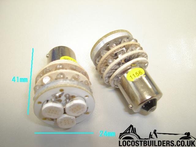

RazMan
| posted on 25/3/07 at 10:10 PM |
These are the little beauties - much, much brighter than earlier versions and the ONLY ones I have found which are not invisible in bright
sunlight.
Raz

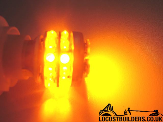

RazMan
| posted on 25/3/07 at 10:26 PM |
The ones I have pictured are actually my indicators but the same assembly applies to the stop/tail & fog lights. They are basically 3 x 1Watt
Luxeon Stars pointing outwards plus 24 conventional LEDs pointing radially (to make use of the reflector)
I get them from eBay and they are not as expensive as you might think - roughly a fiver each.
Check out the supplier
h
ere
Raz
