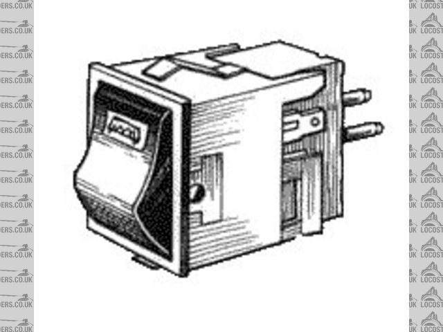

This may sound daft, but it could be your hazard warning switch.
Try turning your hazards on, if they work, then its probably your hazard switch.
PLEASE NOTE those black rectangular rockers sold to kit builders (see 2 posts below), are of really poor quality. Being a vehicle electrician, i have
found that the number of those things i've changed, make me wary of fitting them to anything
[Edited on 26/8/03 by eddie]

eddie
| posted on 26/8/03 at 10:09 PM |
pic didnt come out, try again:
Please feel free in advance to: correct, update, ridicule or laugh and point at any comments made by myself in this post....
