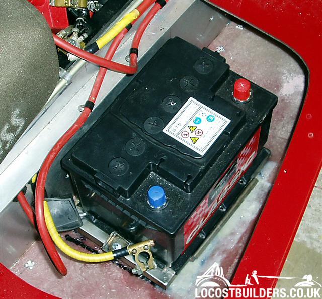

I bought me one of these... link
at Detling. the guy asked exactly what spec the car was and suggested that this was the battery i should go for. So far it is untested though... (does look good in it's ally bracket though )
Dave
