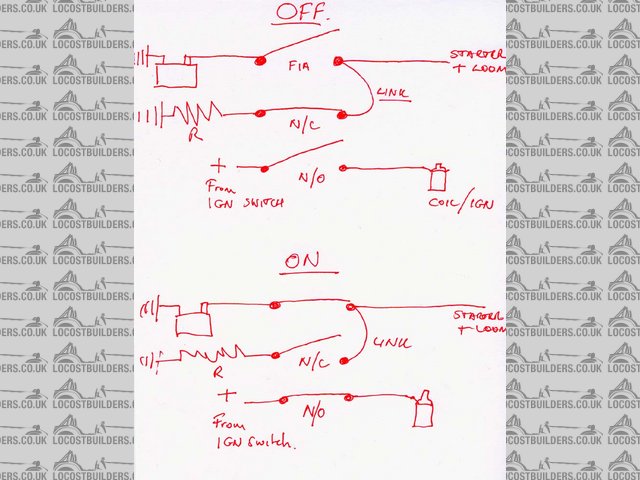

nitram38
| posted on 18/7/07 at 09:23 AM |
The N/C spade is open when the fia switch is ON and car runs so the resistor is disconnected.
If you turn off the fia switch the N/C switch closes and allows the resistor to connect to your alternator (via the main lead) and discharge any
residual voltage to earth, so protecting your alternator diodes.
The other N/O switch disconnects your ign circuit and kills your engine at the same time.
You should treat this as three seperate switches:
  Fia switch diagram
[Edited on 18/7/2007 by nitram38]

nitram38
| posted on 18/7/07 at 09:41 AM |
Phew!!!!!!!!!!!!
Glad to help...........
One other thing, don't be tempted to skip the ign circuit through the switch.
If you do not disconnect the ign when you switch the fia switch OFF, the alternator will continue to run your engine, but worse than that, the
resistor will be permenantly powered and will catch fire!
You have been warned!

nitram38
| posted on 18/7/07 at 10:13 AM |
If you don't run the ignition circuit through the N/O switch, then when the car is running and you turn it off, the engine will continue to run
as the alternator will still be supplying power to your ign system.
In effect you will be just removing the battery from the system.
But when the switch is off, the resister is now connected to your main loom and that is now powered by the alternator.
This will mean that the resistor is now connected permenantly to power instead of just a few seconds.
This will make the resistor so hot it will catch fire.
The fia switch is designed to both cut ignition and protect your alternator at the same time.

nitram38
| posted on 18/7/07 at 10:39 AM |
quote: Originally posted by TimC
Ok, so what you are saying is just make sure that the bridge is in place right?
No, what I am saying is don't be tempted to leave the ignition/coil circuit out.
Make sure that the fia switch is connected exactly as I have drawn it and the N/O circuit kills the ignition when you turn the fia switch off.
