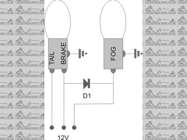

Can anyone see a problem with this?
I want to use my fog lights as an extra pair of brake lights when it's not foggy so I have come up with the following solution. The theory is
that it should enable the fog light to work independently when required (when the fog switch is pressed) without back feeding to the existing brake
light.
Can anyone see any problems?
What type of diode do I need to use?
Raz

I think that should work, one thing that does spring to mind is you may also be supplying the fog warning light switch on the dash and lighting that
every time you put the brakes on.
It may be a MOT failure if this happens as I believe the light must only be on when "FOG's" are on.
I have an LDV that had an interior light on the fog switch so glowed at night and a keen MOT informed me it would fail. You could always use another
diode to stop the voltage going back to the switch!
Adrian

rayward
| posted on 26/9/07 at 07:19 PM |
something like a 1n4001 should do it,
as said another between the switch and fog light should stop the dask warning lamp coming on
hth

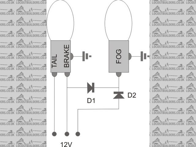

Like this?
Raz
rayward
| posted on 26/9/07 at 07:21 PM |
yep, should work
Ray

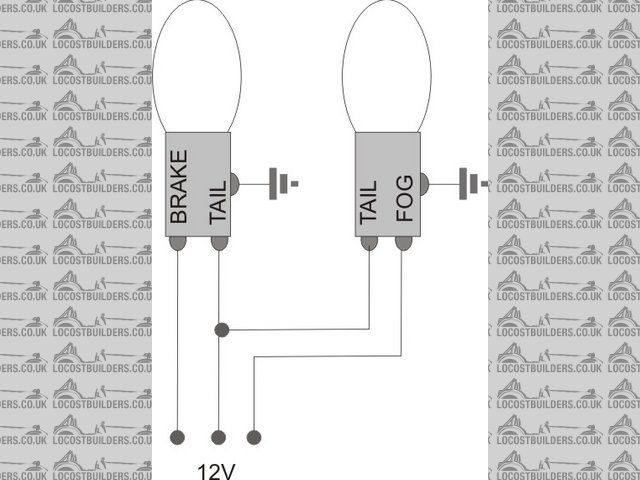

RazMan
| posted on 26/9/07 at 09:25 PM |
All of my lights are LEDs so I am not sure how that will change things.
Come to think of it, if I am only going to have the tails switched on (using the brake part as the fogs) I won't need any diodes now.
It simplifies things a bit
Raz
