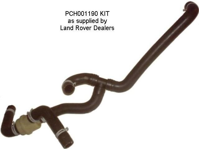

britishtrident
posted on 14/12/07 at 11:42 AM Reply With Quote
QED do one with a by-pass connection fitted which is essential or the thermostat won't open.
However I would recommend
Rover K series PRT thermostat assembly is what is required
THERMOSTAT PRT inc Housing
X-Part part number: PEM101020
See also
http://web.tiscali.it/elise_s1/
http://www.mgf.ultimatemg.com/group2/common_problems/HGF_pages/cooling_system_modifications.htm Rescued attachment LRstat.jpg
britishtrident
