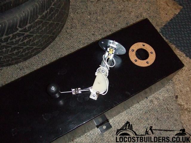

I've been playing with my in-tank EFI pump and sender unit, and have managed to accidentally strip a small chunk of insulation off the earth wire that goes to the sender.
This could potentially short against the positive terminal and presumably result in a rather large explosion. Ouch.
The bit of wire in question has a spade connector at one end and is soldered to the sender board at the other. It would be dead easy to replace. But do I need to get wire with special fuel-resistent insulation, or is the usual stuff ok?

Pic for your reference. Everything is immersed directly into the fuel. All I want to do is replace the black wire.

Mines a different design but it also has live wires dipped in the tank. It has made me wonder on a couple of occasions but I am in no danger of filling the tank with fuel yet.
The white plastic bit towards the bottom has a tightly coiled piece of very fine wire running along the inside of the curve acting as a simple variable resistor with the float arm.
The tank is so heavy it would probably contain a nuclear explosion anyway.

I think I recall that silicone instrument wire is the stuff to use in fuel tanks?
