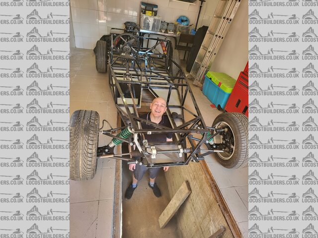

After a long few days in the garage, it's now a rolling chassis!

Looks really good!
posted on 13/6/23 at 06:27 AM Reply With Quote
superb progress and a fantastic workshop

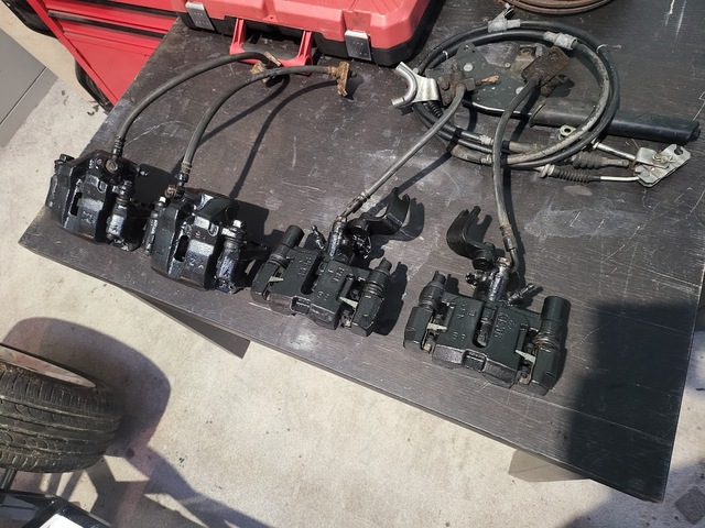

I cleaned up the brakes and painted them with POR15 caliper paint. They look pretty good finished.

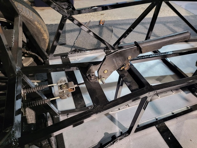

My priority was getting the handbrake working, so that I could move the chassis without it crashing down a steep ramp from the garage.
This is a mix of Sierra and MX5 parts. I've got an issue with the cables fowling the chassis as they exit from the caliper, I still need to modify this.

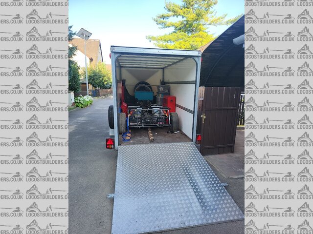

I hired a box trailer and drove a 3000(!) mile round trip.
