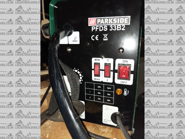

Setting Up "New" MIG welder
Update and seeking information:
Good News:
More 1in 2mm thick wall tube received.
MIG Welder (flux cored) obtained and now put the "arc" welder to one side and started to practice welding with this "new" welder. Trying different wire speeds and amp settings on pieces of off-cut, did a few good welds but on most attempts lots of spatter to so patience and persistence needed to get used to this type of machine (could be earth clamp so stripping twin and earth mains cable to make large copper "pads" to help with earthing) also will try a different roll of flux cored "wire", so will be a while till I get back to welding frame components. I would be interested to hear of others experience with such welders or a pointer to any other forum/posts/sites detailing their use?
Flux cored MIG welder
