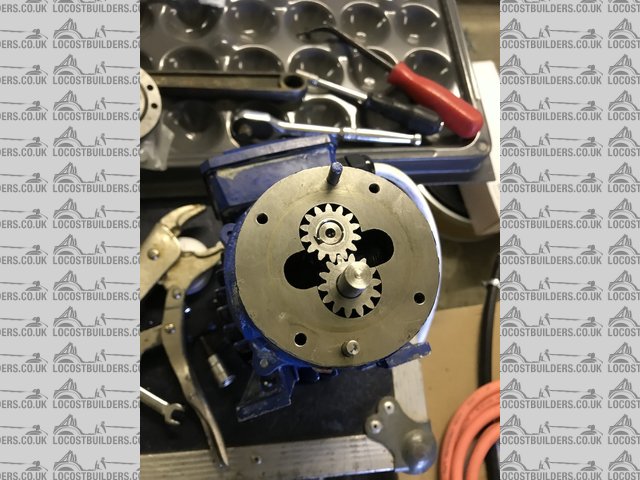

Ok, so for anyone following along at home I have had some success (I think) with this tonight.
First problem I came across was it appeared the pump was not gas tight. I took it apart to find out why (I figured I had nothing to loose) and it
seems the rear seal was not seated correctly. If you are interested, here is what it looks like inside.
LPG rig test 3
I cleaned everything out, wiped out the remnants of hydraulic oil, and put it all back together. All seemed good from both a sniff test (no gas
smell) and ear test (can't hear any hissing). Next time I go up to the yard I will take some fairy liquid and double check that there are no
weeps from anywhere.
It is worth saying that I had the pump on about 10m of cable so I could stand well back and activate it just in case anything bad happened. The down
side of this was I was I could not hear if anything was going wrong, any gas escaping, etc whilst operating the pump.
So anyway, I hooked everything up but didn't connect to the car, and tested running the pump to see if I could get it to prime. It seems there
is some kind of stop valve mechanism in the propane tank fitting that I managed to activate the first time I tried, I think because I was being very
cautious about opening all the valves at once and probably managed to create a vacuum somewhere. The second time I just opened all but the valve on
the car filler end, ran the pump for a few seconds and hey presto I had liquid when I cracked open the valve at the car filler end.
LPG rig test 2
Then hooked it up to the car and weighed the cylinder so I had a starting position. Ran the pump for a few seconds, went over and checked for any
signs of leaks, few more seconds, re-check, etc. Did that until I had 30 seconds of pump run time. Checked the cylinder and the weight had dropped
indicating transfer of gas. Started running for longer bursts. First 10 seconds at a time, then 20s, then 30s, then eventually a minute at a time
checking cylinder weight between each run.
Should also say at this point the car was not empty so I wasn't able to say with accuracy how much space was in the tank. As I have no pressure
relief at the moment it was important that I did not get to the limit of the car tank's fill valve. I took a conservative estimate of the gas
used since the last fill (based on miles) and halved that to set a max I was going to attempt to fill today.
LPG rig test 1
Sorry the pic is a bit dark.
Anyway, upshot of all of this was that after 6 minutes of total pump run time the propane tank was 6.5kg lighter than when I started indicating 13
litres of gas had been transferred. That is a pretty poor flow rate, about half what the manufacturer claims. That might be because the flow rate is
for hydraulic oil which is far more viscous, because the pump is old and the tolerances in the housing are not what they used to be, or because that 6
minutes was made up of short duration pulses. Who knows, but it will do for now.
So there we go: yes, it is possible to DIY fill from a cylinder without spending thousands or going up in a mushroom cloud.
Next step is to run the car completely out of gas and attempt to pump the rest of the orange cylinder in.
After that, hook up some kind of pressure relief so that I can't overfill the car tank. I have not been able to find any data about how much
pressure the tank stop valve can take but the relief valve at my local (retail) filling station is set to 75psi so I guess I use that as a guide,
perhaps start at 50psi and turn it up from there.
After that, get some bigger cylinders and try to pump into the bulk tank so I can prove that filling from the bulk tank into the car works without
having to invest a few hundred in a full fill.
