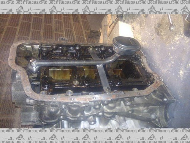

A bit more progress this week - I made the oil pickup pipe , welded the sump plug in and added the re-positioned dip-stick . Just a quick leak test
and a coat of paint and it will be fitted to the engine thats going into the car .

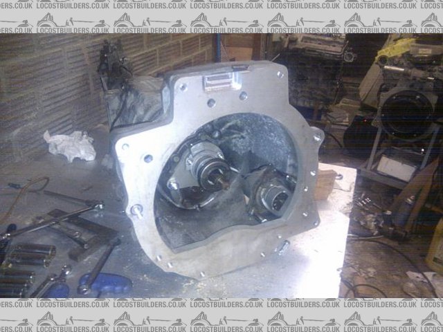

I got the oil pickup mounted , and test fitted the starter and adapter plate , as well as finishing the clutch slave cylinder setup .
Then , after a test fit to check starter engagement (perfect ! ) , it was out with the trusty engine crane , and in went the engine .......

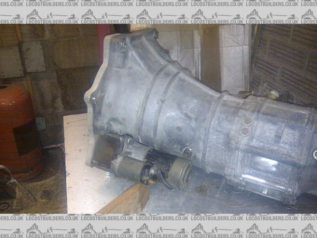

I found a small problem tonight while tackling the starter wiring.............tonight was the first time I had fitted the starter with the complete
engine and box in the car , and the solenoid hit the tunnel side
The easy answer was a small `adjustment' to the tunnel.................or take it all out and re-make the engine mounts to move it across a few
mm...............
So after a session with a hammer , in it went , on went the re-worked wiring , connect the battery .................................... and it turns
over on the key
To say that I am a happy bunny is an understatement !

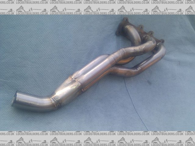

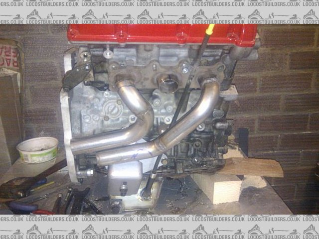

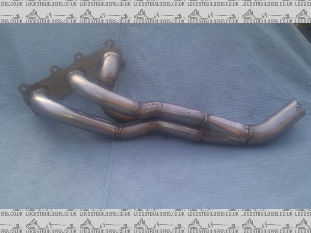

Since the post man did the business this morning and turned up laden with stainless bends and tube , I got well stuck in and made these -
I did have to pop in to work first thing to borrow a welding mask - mine packed up , and after only twenty years

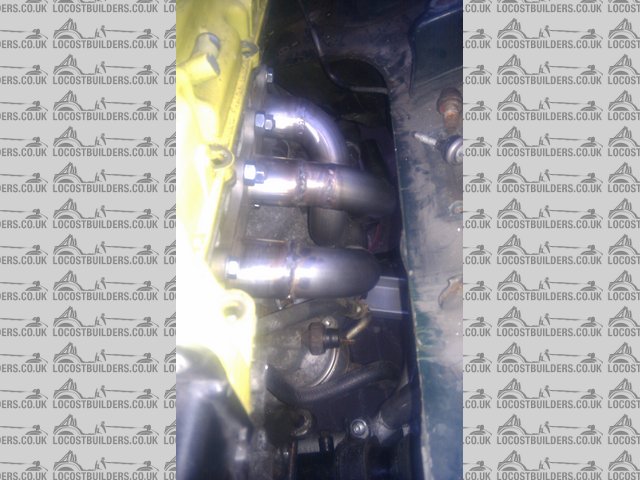

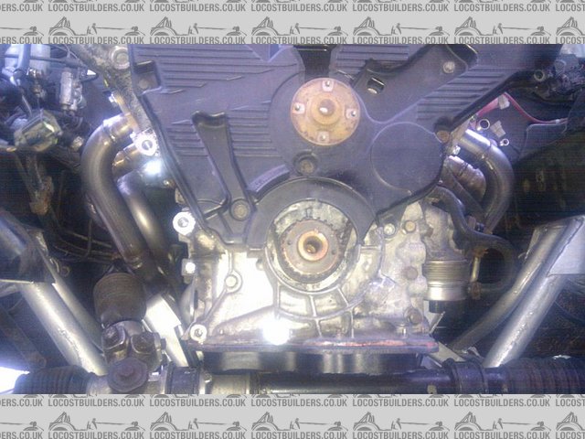

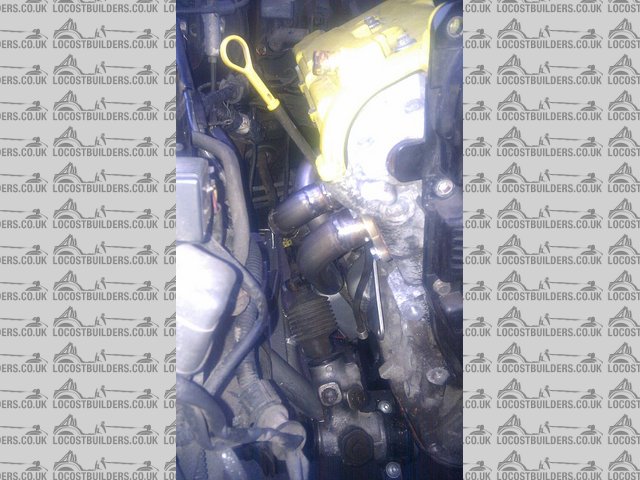

Now that the rubbish Easter weather is over , I got under the bonnet tonight after work and fitted the exhaust manifolds , and oil filter
`bracket' (along with the stock oil to water cooler)
They were a bit of a struggle , getting past the steering column was not easy , but as the first complete manifolds I have ever made I am quite
chuffed

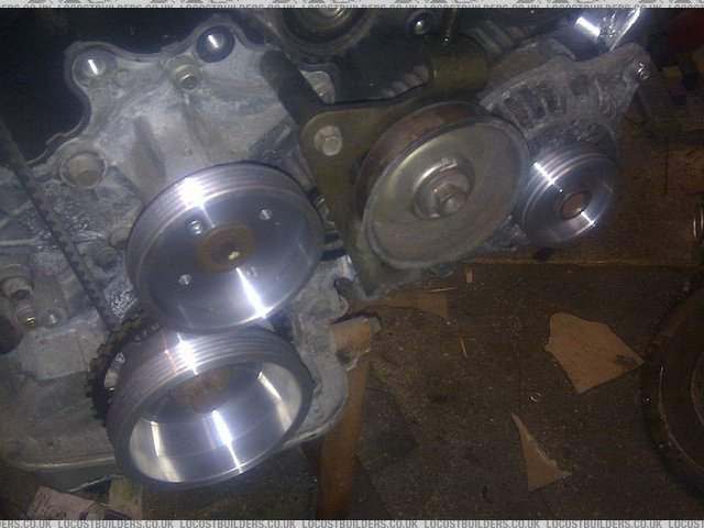

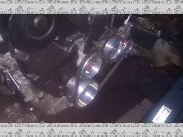

Just a little update - some alloy bar I had been waiting a week for arrived today , so a quick session on the lathe saw these finished tonight -
I'm trying to resist the urge to make an alloy idler pulley to complete the set , but it would finish it off nicely

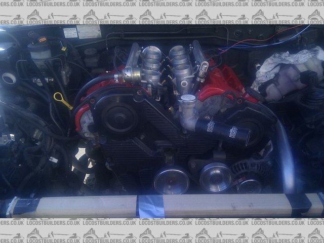

Slow progress here........but progress never the less ! The weather is making it kinda hard to do much - I really need to get a heater in the shed

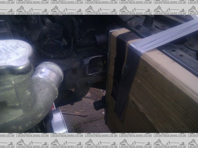

But tonight , the postman brought me an M3 tap and 2.5mm drill , so I fitted the trigger wheel to the bottom pulley , and finished off the alternator
mount - heres the result
My new radiator arrived as well - but some idiot has put a chassis rail in the way of the fan switch
So a bit of `modification' needed

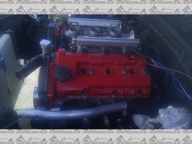

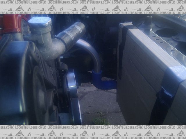

| posted on 12/5/12 at 09:36 PM |
The radiator is now in place - I had to cut all the stock mounts off , trim a small amount from the drivers side rail (then seam weld the missing
corner) , and cut a recess in the left side to clear the fan switch (which I filled in with some 2mm steel)
With the rad in place , I then bent a bit of 1 1/4 alloy pipe to run down the left side from the thermostat connection to the bottom hose fitting on
the rad .

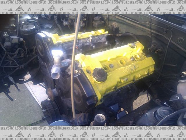

I allso got the re-painted cam covers on , fitted the throttle bodies and finished the linkages , fitted the FPR and started on the fuel pipes , and
finished off the alternator wiring .
Quite a successful day - and if the sun shines , I'm hoping to get the exhaust finished tomorrow

| posted on 16/5/12 at 02:37 PM |
What spacing are your ITBs at Claire? My body for cylinder 1 doesn't have room to fit the TPS on it, but yours does.
Sun Tzu, The Art of War
clairetoo
| posted on 16/5/12 at 08:34 PM |
The ITB's are in line with the ports - 97mm centers - but the TPS has been rotated 180 degrees (by machining a second flat on the spindle dead
opposite the original one)
This allows the TPS to fit at the front - my early setups had the linkage at the front .
Its cuz I is blond , innit
Claire xx
Will weld for food......

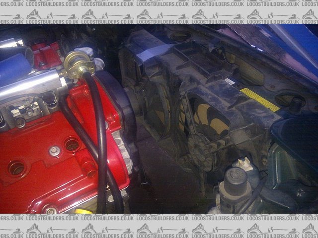

| posted on 16/5/12 at 08:50 PM |
Since I decided to use a Golf Vr6 radiator , I figured I may as well use the fans to go with it as well - so a quick visit to ebay Sunday morning
netted a complete slam panel , with twin fans and a rad thrown in , for the princely sum of £12
A quick session with the jigsaw to cut it down to a usable state and it now fits - still a couple of brackets to sort , as well as a bit of tidying up
- but the plan to try and make it all look like it left the factory with this engine in is still on track
Next bit to work out - anybody know where I can find the Golf 2.8 Vr6 fan wiring ? It has a four pin fan switch , as well as a four pin connection to
the fan motor.........

| posted on 19/5/12 at 01:00 PM |
Ah, that'll be why then. Was thinking I'd somehow fitted mine differently. Is there any advantage to having the TPS at the front?
clairetoo
| posted on 19/5/12 at 01:43 PM |
The TPS was moved to allow the linkage to go at the back , where there is loads more room - thanks go to Chris (ITI_UK) for this mod
