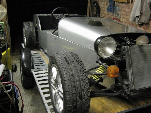

posted on 13/1/11 at 11:02 PM Reply With Quote
I brought the car back from paint shop tonight, now starts the refit of the fibreglass and other parts without scratching it to bits!

Finally got the car out of the garage today in between the rain, so not a sunny day for pictures, but looks OK.

Not that much different as one can see.
Now give me sun and warm days!
