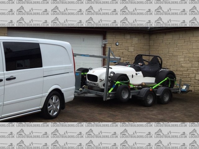

| posted on 6/6/17 at 05:35 PM |
Re U2U from Steve.
Must be the breeding season.
How to tie down. All 4 wheels.
[Edited on 6/6/17 by 907]
