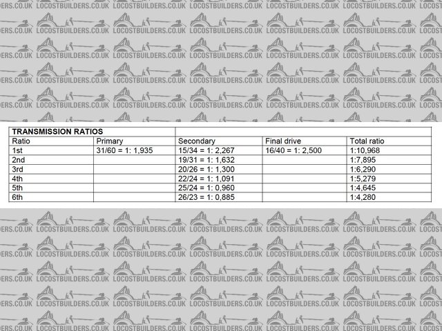

The Aprilia ratio's are:
Cheers in advance!

If you are trying to get the same gearing then you need a 36 tooth sprocket on the back. I think

My calcs agree with Daviep, 36 tooth rear sprocket for the same gearing as the bike.
However you might consider slightly lower gearing as you will be moving more weight with the Trike.

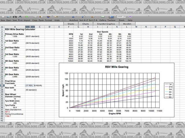

I wrote a gearing calculator for the RSV in Excel which you are welcome to. The
built in rolling circumference calculator uses a fixed 97% of static circumference which seems to tie in with published in gear speeds, but obviously
you can change this to suit.

Going on 10500rpm rather than 11000, a 53 tooth rear sprocket would give 119mph on a 21.68 Inch diameter tyre.
A 60 tooth sprocket would give 105mph. If you really are going to rev it out to 11000, 110mph.
I would have the 60 tooth sprocket as the vehicle is going to be all about point and squirt at speeds under 100mph.
Anything more is irrelevant.
Mikes calculator backs this up with the following intermediates through the gears.
1st 39.93
2nd 55.48
3rd 69.62
4th 82.97
5th 94.28
6th 102.32
40mph in first is still enough for anyone.

This is my favoured combo so far... could be a bit wearing if cruising though.
