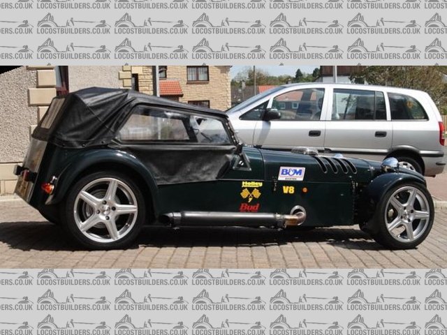

A mate had been looking at a Formula 27 with an RV8 engine that was coming in at bargain-money as its one and only owner was emigrating in a matter of
days and no-one was buying it at the advertised £7k.
He dropped his interest when he realised it was an auto... and then I stepped in and threw a silly offer at it... which the owner accepted! Doh!
When will I learn! I don't need any other projects... they're coming out of my ears!
Anyway... its a 1998 kit and was IVA'd in 2003. It has an RV8 with Edelbrock (Weber) 4-barrel carb and a BW65 (or 66... whatever was in the
Rover SD1) auto box. It's only done 180 miles since then... and most of them were going back and forth for MOT!

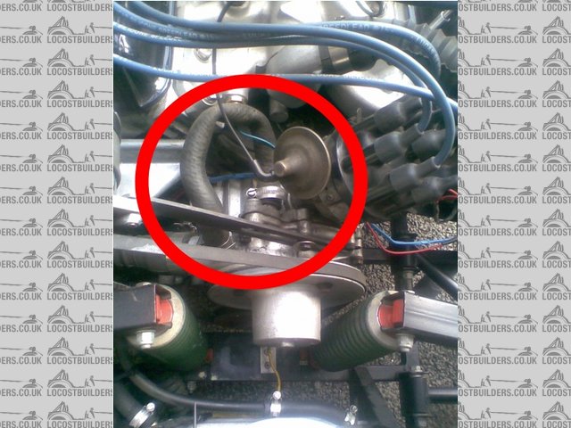

There's a snap of the car below, but can anyone help me with a name for the hose in this picture? It looks like it's a straight piece of
pipe which has been squashed to suit, so is probably not doing it's job very well (whatever that job may be). If I get a name, then I can
search for a factory-replacement part that is shaped for the purpose. Well that's the plan anyway...

That isn't factory at all, the pipe should fit between the union at the back of the pump, into the steel pipe which runs under the manifold,
just visible towards the yop of your circle, at the back of the manifold there should be another union, this and the steel pipe running under the
manifold feed the heater.
I can't remember what the other union on the pump is for.....

Ref the hose - it seems that the two pipes shouldn't be joined together but you may not have a bypass on the thermostat housing. here's
what mine looks like

Just looked through the notes again and it has a Rover P6 short-nose water pump.
I'm guessing there will be no 'off the shelf' solution then!

Basically you can take the hose in question off and cap the hose tails.
The hose tails are for inlet manifold heating and for the heater it doesnt look like you have either.
There may be a plate at the rear of the manifold or a hose tail if there is you can run a hose front the back of the pump to the front spigot on the
thermostat housing (this would need to be drilled through (check the manifold to see if it has a hole behind the spigot)) then you would run a hose
from the rear hose tail tothe hose tail on the pump top.
hope this makes sense Ray

one hose hoes to the inlet manifold, the other goes to the heater - this is a steel tube that is attached under the manifold (I refer to original
manifold for SU carb).
This hoses are offset so you can't use a straight length as it will kink.
There is P6 specialist, name escapes me right now who are the only peeps that sell these hoses. ... be back in a mo'.....

I am sure that heater hose is wrong.. If you cap it off there is no thermostat bypass route.
Check how the pipes should route before capping them off.
