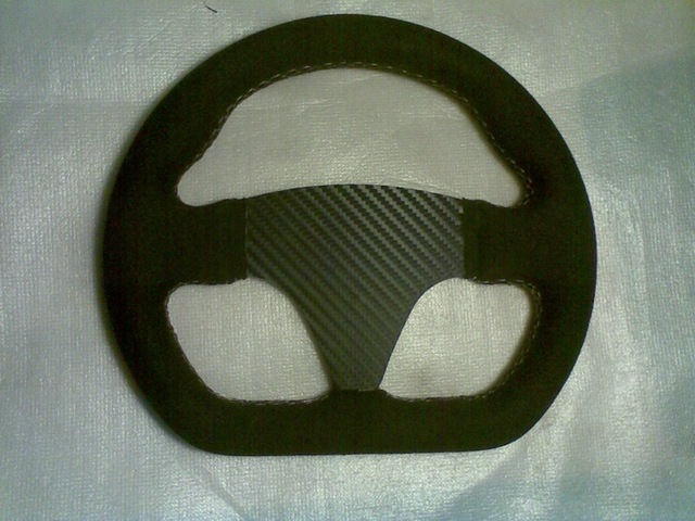

I bought a SPA steering wheel and QR system for fitting to the trike a while back. Neither was cheap, but it's an area where I was happy to spend a little more.
Decided to fit the QR to the wheel tonight. Drilled the three holes then put through all three hex-head bolts and tightened the nuts to halfway.
Tightening the bolts started to get a little hard-going when they were coming through the nyloc. I then noticed that the hex-heads on two bolts were starting to slip so stopped to replace for some others. The buggers wouldn't come off, so had to apply a little more force and then the heads rounded completely!
Never-mind... I'll get the bolts off. Er, no I won't... they're made of butter too and stripped with little persuasion!
Had to cut them off with the Dremel and have marked the face of the wheel-centre pretty badly
Why bother supplying cheap sh*te fasteners with supposed high quality goods???

Were the fasteners you had problems tightening stainless steel?
Somtimes, if a nut and bolt are both stainless both surfaces will bind tight onto each other, before the components are under clamping load.
The solution is to lubricate the threads, or only have one of the threads in stainless.
