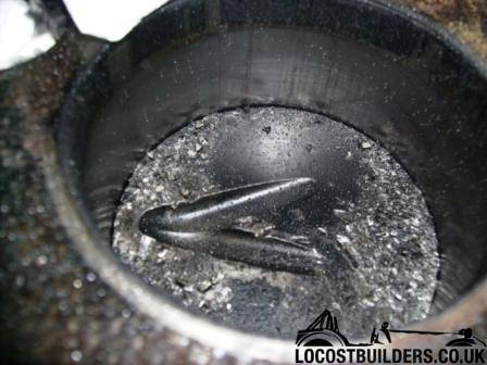

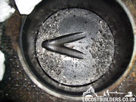

Unfortunately I found shrapnel melted to the top of one piston and the area around the valves - suspecting at first a piston ring had broken up.
This is the first time I've tried any engine work so I'm having to take things slowly - lifting the cylinder head with manifolds out of the engine bay on my own and 20 yards to the garage nearly killed me off though!
I called in for a new head gasket and the guy in the shop suggested the shrapnel could be "fingers" which heat up to atomise the fuel so after some research i found this on the landy forum.
"If it is necessary to remove the cylinder head,do NOT be tempted to have it skimmed.This should not,in any event,be necessary,since the head is a large and rigid iron casting,and not,to the writers knowledge,unduly given to warping. Skimming the head will(not may,but will) result in the aluminum"hot spots" recessed and pegged into the head falling out in service.When this occurs,the engine will be a write off.Head overhaul is a specialist job,and must be treated as such.This danger cannot be over emphasized"
It seems likely the damage is due to these "fingers".
Does anyone know if the above is correct - the engine is a write off? It started and ran reasonable on 3 cylinders before I took the head off.
How can I tell if the head has been skimmed or off before?
Is there any other reason why these fingers might fall into the cylinder?
if the engine isn't written off can I replace these fingers - best probably in all cylinders, then I can overhaul the valves, piston rings etc and rebuild.

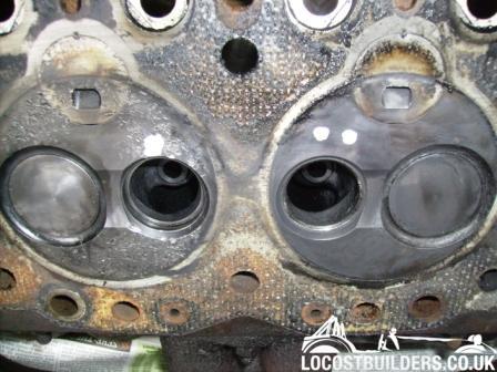

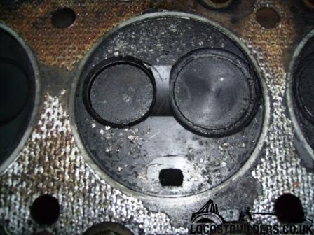

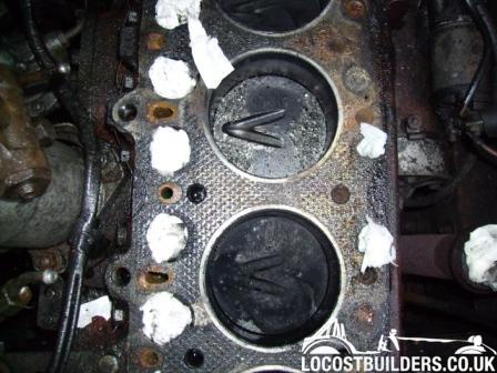

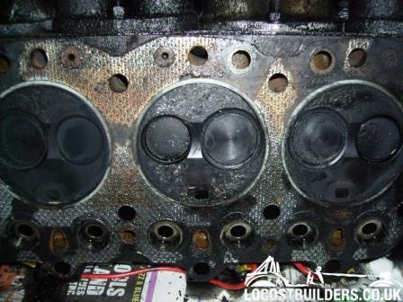

posted on 24/7/12 at 09:42 AM Reply With Quote
pictures added
there is a slight scoring in the cylinder block, I've not cleaned up the head yet but it does seem ok so far.

daviep
posted on 24/7/12 at 09:56 AM Reply With Quote
Have you removed the glow plugs and injectors yet? If so were they whole? Is there any damage in either port behind the valves? Just thinking maybe a tip has fallen off or debris has been ingested. definatley something been rattling around in there.

RedAvon
posted on 24/7/12 at 11:12 AM Reply With Quote
Hi Davie,
I took the injectors out and they seem fine, not the glow plugs yet. I've been trying to identify where the "fingers" would have entered the cylinder I think it must be the bottom slot in the last picture?
I've not taken out the valves yet either - this is my first venture into taking an engine apart and don't want to mess anything up - that said the shrapnel has made a pretty good job of that!

daviep
posted on 24/7/12 at 03:03 PM Reply With Quote
Any auto engineers will recondition your head, what do you get for £395? New valves, new guides, new valve seats, new PC chambers? If so then £395 seems like a good deal, all depends what is replaced and what isn't.
However given that it sounds like it will need bored due to cylinder damage you will be looking at a lot of money for new pistons/rings etc. Once you spend money on a re bore then it seems silly not check the bottom end over, so you may also be looking at a crank regrind and a set of shells.
If you go to the expense of a head overhaul, a rebore and a crank grind then you would be silly not to have the injectors overhauled also.
Reallisticly I'm guessing your engine is beyond economic repair unless you want to carry out the overhaul just for the experience.

paulf
posted on 26/7/12 at 08:32 PM Reply With Quote
Originally posted by RedAvon
Hi Davie,
Is the exhaust valve in the picture seated properly in the head? Its difficult to tell from the picture but it looks as if it may have lost a valve seat insert which may be where the debris came from.

RedAvon
posted on 27/7/12 at 09:03 AM Reply With Quote
Hi Paul, thanks for the input.
This theory would explain the dint in the top of the cylinder head at about 1-2 o clock of the exhaust valve and the semi circular scratch between the two valves.
I've uploaded another photo and will try and get the valve out at the weekend.

RedAvon
posted on 1/8/12 at 11:52 AM Reply With Quote
Paulf was spot on as per picture the valve seat has fallen into the combustion chamber.
I'm going to ask whether a local engineering company can put in new valve seats throughout - maybe new pre-combustion chambers and re-grind the valves.
I'll also need to get someone out to look at the slight scoring on the chamber sides and consider new rings and shells while the head is off.
