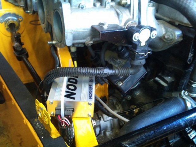

I used a NODIZ..
  NODIZ unit
Coil Pack mounted on old dizzy
  Module onto old distributor
Trigger wheel welded onto pully
  Trigger wheel & sensor
Mapping on rolling road was essential - well pleased with results..
