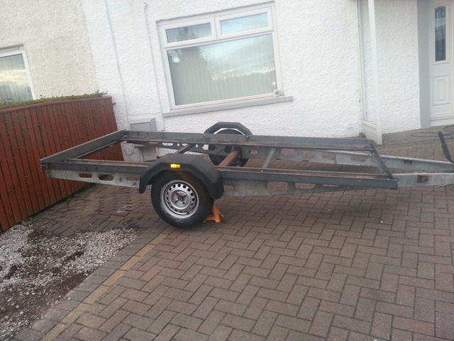

Started out looking like this:
  trl 1

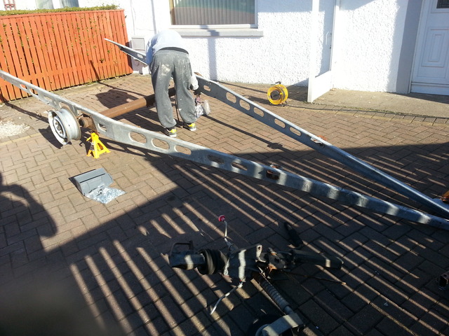

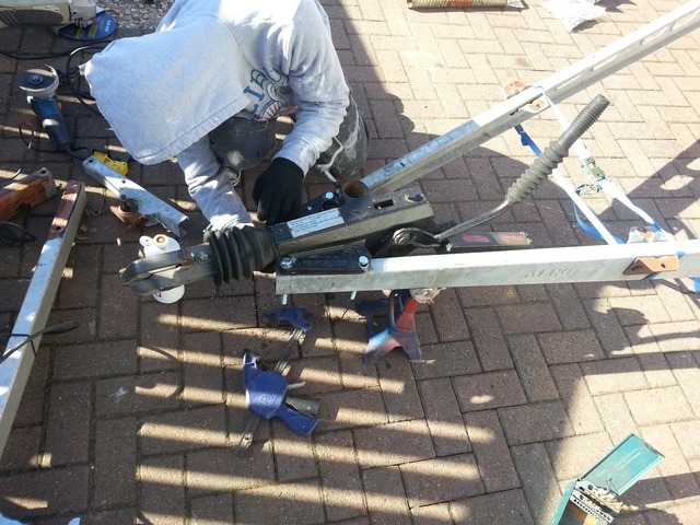

My old scrap heavy trailer happened to have a very nice Indespension triplelock hitch so after the neck had been slightly shortened on the caravan
chassis this was transplanted by the hooded one (my eldest) despite it looking like he's trying to steal it.

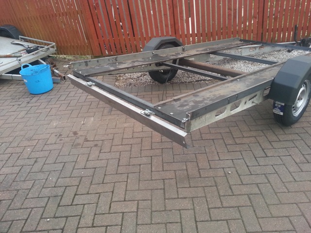

I had some steel runners pressed by Nicol Mackay down in prestwick, who by the way were extremely helpful despite being a huge manufacturing co, the
sales bloke even took me for a wander round as I took an interest in what they were making. These were slaved on along with front and rear

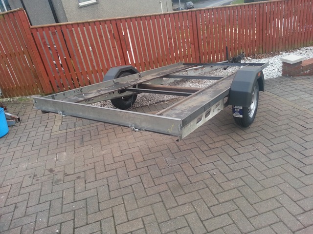

crossmembers.
Couple more cross members fitted, wheels and mudguards slaved on.
Where the trailer lives I was forever breaking lights so i wanted them up and out of the way so I had a steel channel pressed so the lights and no
plate will be up a bit higher, I have fitted hinges so this will swing out of the way for loading.

The caravan chassis made it a very simple build indeed, only prob was the neck was too long so it had to be shortened and new crush tubes made up, but
even that was straightforward. I haven't weighed it yet but I'm hoping for 200-250 kg all up when galvanized. I only have a 1.8 Zafira to

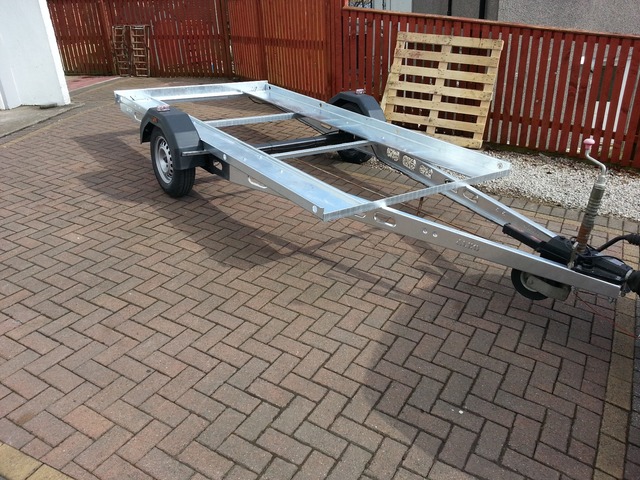

I've finished the build today, has all been broken down into bits and all been deburred ready for when I get chance to get it to the
galvanizers.

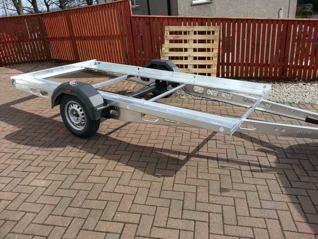

sdh2903
| posted on 4/4/13 at 08:40 PM |
Trailer is now finished!
Picked it up from galv after the easter weekend and finished assembly this morning, just have some load resistors to wire in to stop the indicators
going mental and some reflectors for the back. Ive updated the cost sheet for anyone whos interested. Total came in at around £500 all in which is
around half the cost of an equivalent brian james.
Its light too, the galvanized bits were 140kgs so with the axle, wheels etc I estimate it to be 225kgs all up, the zafira is certainly happier towing
it than the old one!
Chassis: 75
Steel Pressings: 160
Steel Angle: 34
2 x new tyres: 76
2 x rear lights (used led items off here): 15
Bolts, nuts and washers: 26
Cable, 2 x marker lights, hinges, 2 x prop stands, 2 antiluces: 40
Shotblast and paint of old wheels: 20 (mate rate)
Galv 140
Scrap refund of old trailer -80
[Edited on 4/4/13 by sdh2903]
