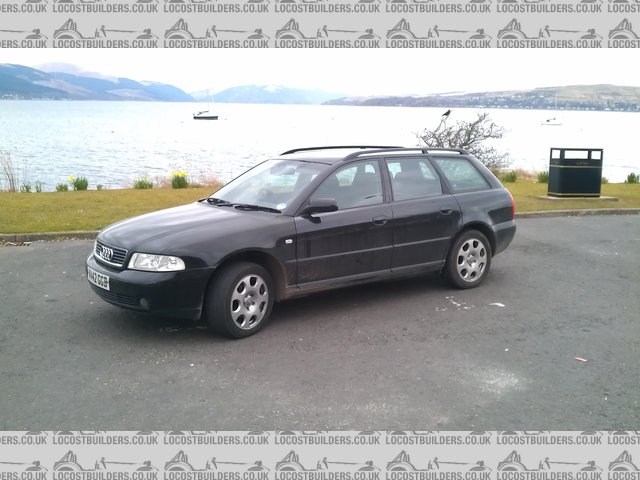

here's the beast
not bad for 800 quid i guess...
