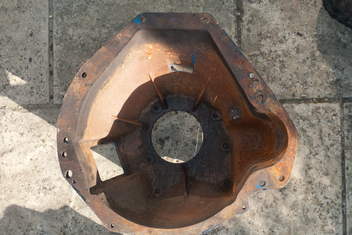

the cologne pattern is quite distinctive looking with the top 2 bolts very close together:
the essex was only ever fitted to the older 4 speed boxes (type 5) and looks like this:
