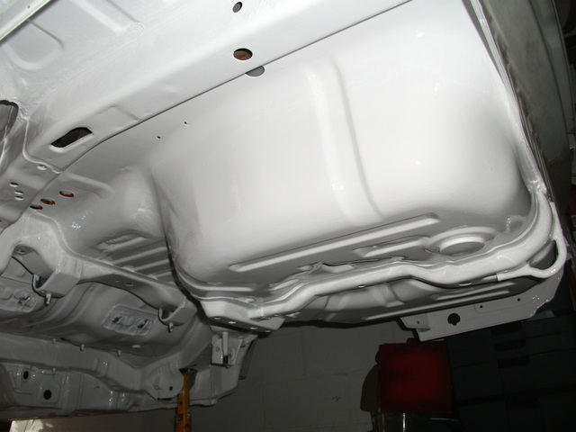

I used kbs rustseal on my anglia as I wanted off white and you cannot get por15 in that colour in the UK. But it is all in the prep, do as they suggest - wire brish, aquaclean degreaser, clean water wash, metalprep, clean water wash, leave to fully dry, paint (I did 3 coats). Remember this stuff stick, get it on kpyou skin and you have to wait for your skin to shed, wear gloves anspd a paper suit. Not cheap but I am happy with the results for a brush job.
Pictures here before and after - http://anglia1968.weebly.com/bodywork.html

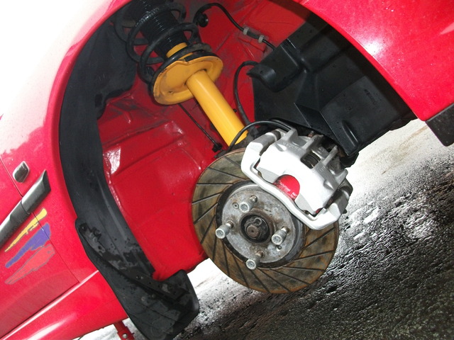

Hi, when I did mine i etch primed the bare metal, then 2k primer followed by seam sealing all the joints, followed by 2k primer again then stone chip and finally the body colour
[URL=http://s177.photobucket.com/user/Gregkimb3/media/IMG_0588.jpg.html][/URL ]
[URL=http://s177.photobucket.com/user/Gregkimb3/media/IMG_0590.jpg.html][/URL ]
[URL=http://s177.photobucket.com/user/Gregkimb3/media/IMG_0591.jpg.html][/URL ]
Unfortunatley I don't have a pic of the underside in colour but you can see in the wheel arch how it looks
