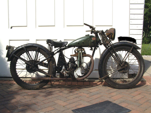

| posted on 14/10/15 at 09:41 PM |
The thing with diesel is you have to be really patient, it took between 12 to 18 months for this old beeza to free off.
When it eventually got stripped to rebuild, there was little sign of it ever being seized.
It had sat in a shed with a leaky roof since 1957
My advice is get on with all the other stuff, keep chucking diesel in and try it every couple of months to see if it's freed off.
Great project, will follow with interest.
