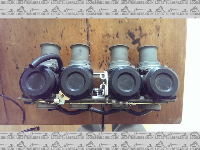

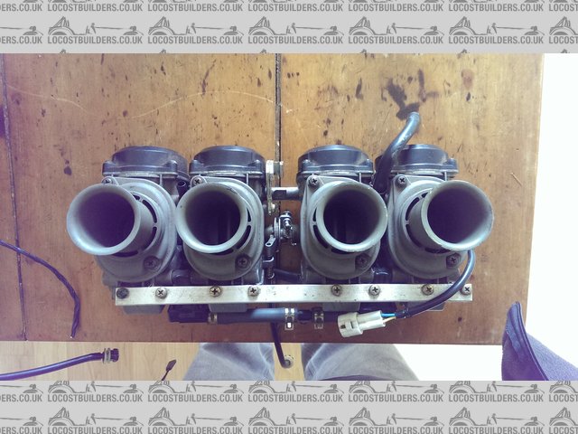

I've got these kicking around but not sure what they are off. 36mm Throttles. Any body go any ideas?

They look very similar to my Yamaha Thundercat's carbs.

My first thought was they looked like my Yamaha R1 carbs, but the trumpets dont look right. There should be a number stamped on the flange...
Yep, pretty sure they are from a Thundercat (YZF600R).

These are yzf600r carbs I bought, look pretty similar, thundercat uses the same (or may be same bike). The yzf600r are mounted almist vertically so
good for v6,v8 engines.
Two sets (minus one carb) on my mx6 2.5 klde, got it running once but never again. I liked the idea of a dizzy and carb engine.

Spot on - Thundercat YZR600, thanks everyone.
