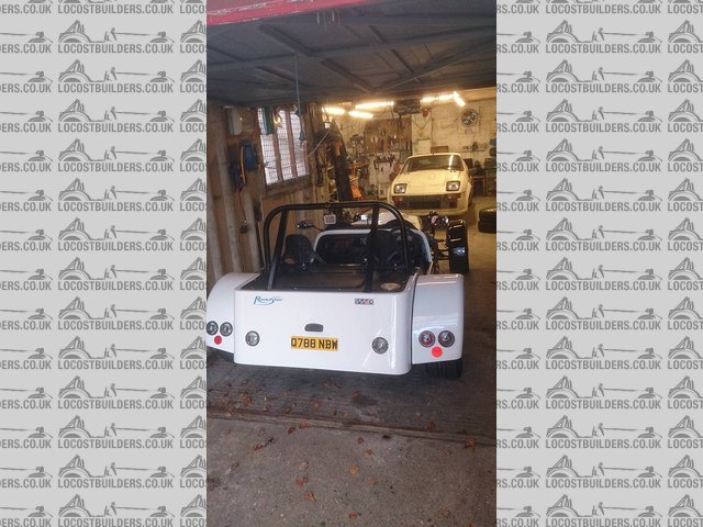

Nickp
| posted on 6/11/17 at 05:04 AM |
Safely back home now.....
Nickp
| posted on 6/11/17 at 05:05 AM |
Meeting its new 'roomie'.....

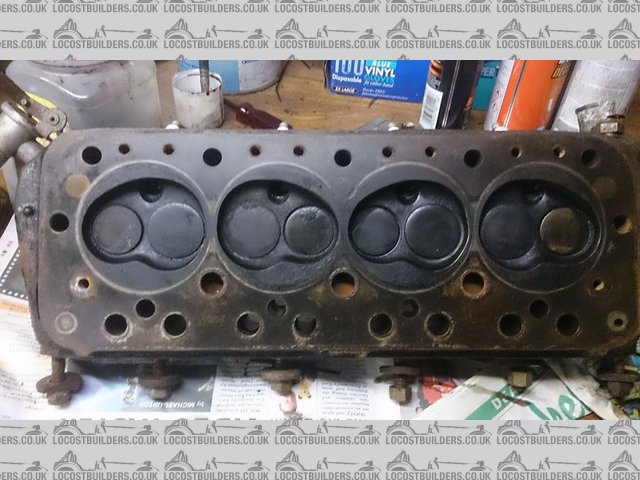

| posted on 7/11/17 at 06:47 AM |
Woohoo +.030 overbore means I've got a full 1301cc of throbbing A series power!! Head seems to have been ported too and has double valve springs
so may have a hotter cam in too. Valve sizes are only std 1275 sizes but I'm very happy with what I've found so far

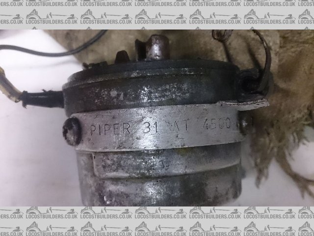

Nickp
| posted on 7/11/17 at 05:18 PM |
Further evidence that there's a performance cam hiding in there? Hopefully this is a dizzy matched to the cam by Piper.

Mid engined?
I'm gonna see how the old A series goes first.
So far the positives are-
Overbored to 1301cc
Head very nicely ported, mainly on inlet side, where the A series needs it most.
Cam has near 300deg duration and 10.5mm lift (checked with degree wheel and dti gauge).
Could be a little revver and make about 90bhp if I'm lucky
If not then I'll be looking at head or engine swap
