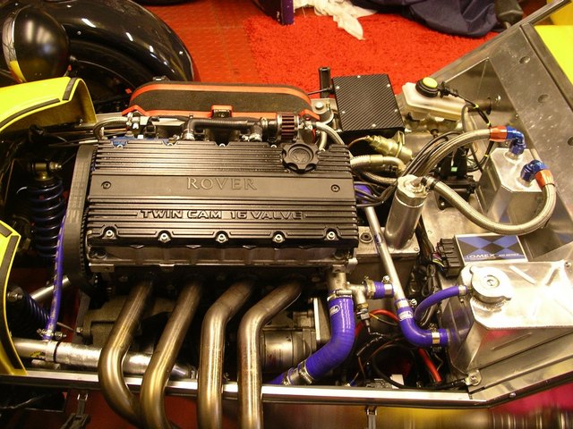

Hi
I'm really struggling to visualise the K series in my 'new' Striker', especially as I've spent a year thinking about putting
it in a mid engined car (Elise).
I've spent ages searching but would be grateful if anybody could share photos / links of their k series installations. Any '7' not just
JP cars would help!
Thanks in advance!
Wyn

Here are a few pics :
https://flic.kr/p/pVkKyU
https://flic.kr/p/qaBprE
https://flic.kr/p/pVtDsr
The Full Picture Stream of my re-build can be found here :
https://flic.kr/s/aHsjZ7Zp1K
If you need any more pics or video and dimensions then let me know and I'll get the tape measure out for you.

The none remote thermostat location is on the bottom hose not the top this is one of the causes of the headgasket failures. I have two cars running k
series engine both have been fitted with a freelander remote thermostat, car builders solutions also sell a thermostat. The other option is to buy a
standard k series stat with housing then it in the top hose and keep the other housing but without the stat.
Matty
