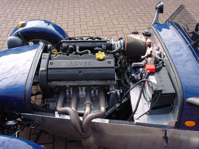

iank
| posted on 11/1/15 at 10:02 PM |
Not mine, but a couple from the archives
Anonymous
