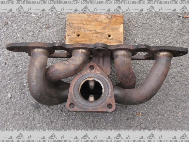

Just to let U kno, email sent. These are the pics.
  Zet_Zorst_01
  Zet_Zorst_02
Hammy360
| posted on 18/8/16 at 12:16 PM |
  Zet_Zorst_01
  Zet_Zorst_02
Thats great, not seen one like that before, is this for a system that exits through the side panel ?
