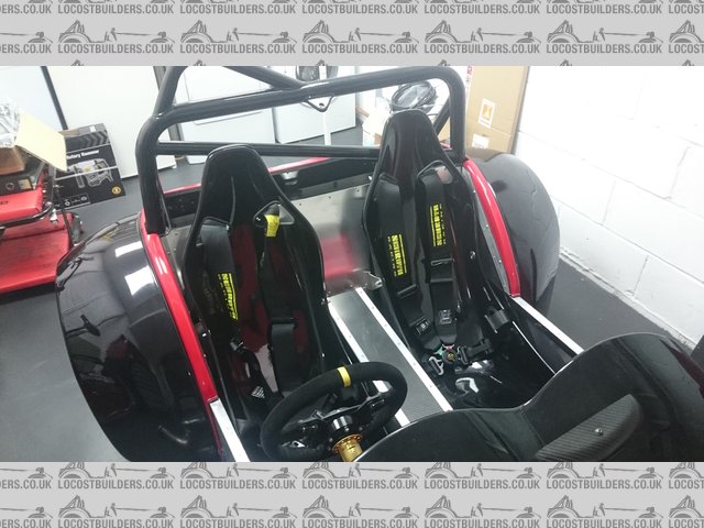

I had a few minor tasks to do (if there is such a thing) to get ready for MOT and Rolling Road. First job was to fit the passenger seat and harness
properly which I did last weekend.
