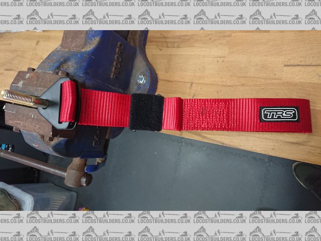

After lots of thought and feedback from various people I have decided the perfect answer does not exist so i stopped looking for it.
My idea for solid points front and rear were shelved. If you hit a solid point of the chassis at any speed the chassis is damaged. At least if a
flexible strap damages bodywork whilst being towed its just body work. So I ordered two adjustable TRS two straps and got on with it.
I started out getting some plates cut from steel to clamp around the front and rear chassis rails. I used some spacers to allow me to bolt it all up
tight without crushing the chassis tubes. The spacers also stop it twisting as they make it a snug fit around the chassis tubes. With suitable nuts
and bolts they look like this off the car
  Clamp Close
I offered them up a few times and adjusted the length adding tie wraps to holds the excess material and double as fixings for heavy duty Velcro.

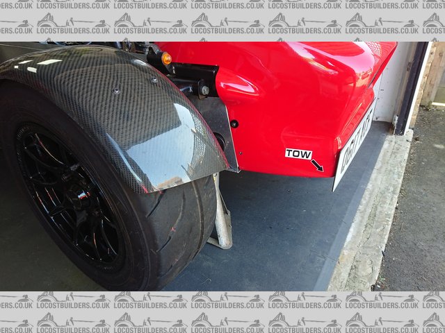

Finally a few 'Tow' signs to help the marshals find them if ever needed
  Nose label
If needed both ends just pull down to release from the Velco and both extend out past the bodywork once pulled down. With any luck I will never need
them
