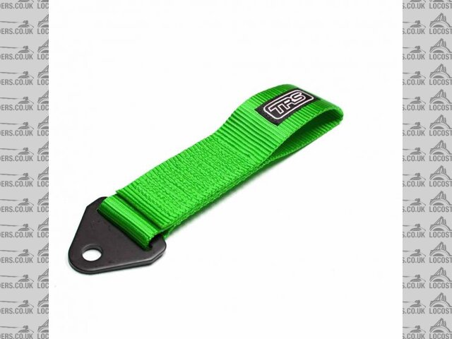

  tow-strap-nick205

Not a J15 builder/owner, but can you make use of something like this...
  tow-strap-nick205
Thanks Nick. The problem with a strap like this is that the chassis is such a long way back under the front clam that it would push the clam up and
break something!

| posted on 3/10/22 at 10:13 AM |
  tow-strap-nick205
break something!
Noted - as I say, I'm not a J15 builder/owner so not familiar with the chassis/bodywork layout.
From the feedback above where "ttalps2000" has had his towed using the roll over bar, it may not be a problem any way. Additionally can you
check with the track at the time of booking what their rules are. Have a couple of photos of your car ready to email for certainty as well.
