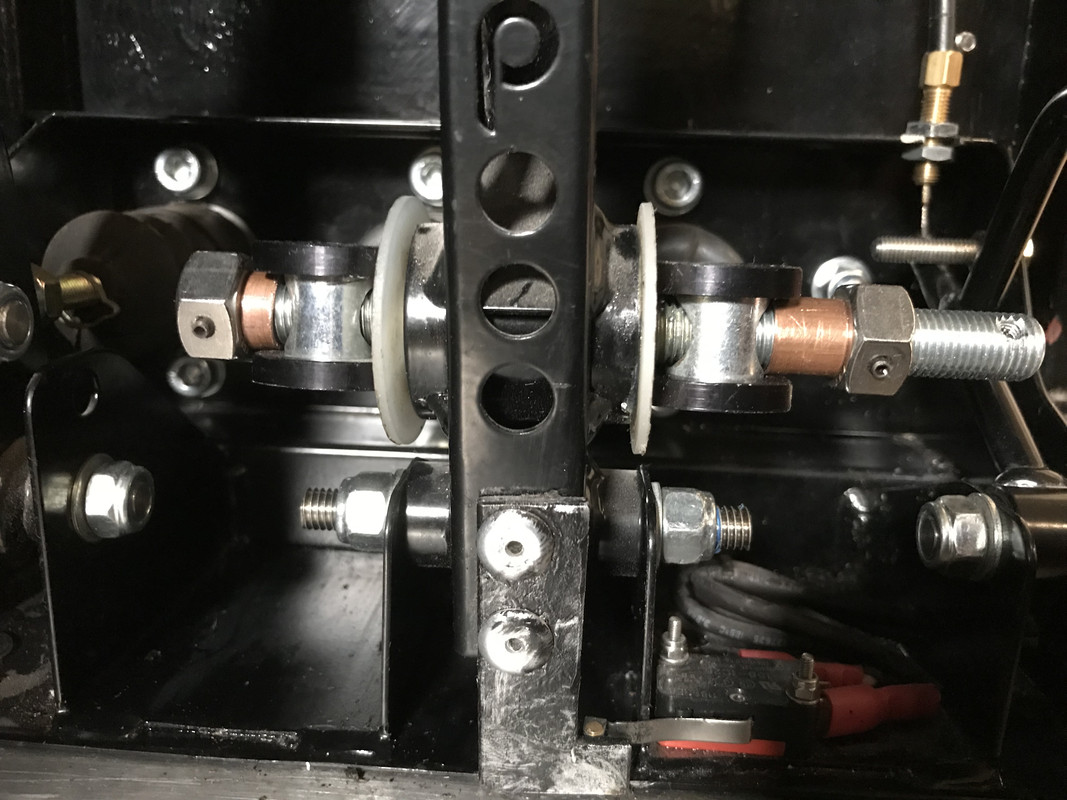

Worked on OBP universal pedalbox, set bias bar centrally and locked in place with supplied nylocs. Fitted microswitch for brake lights. Installed in
car and ran front to back brake pipe.

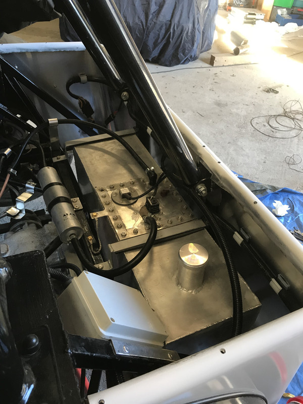

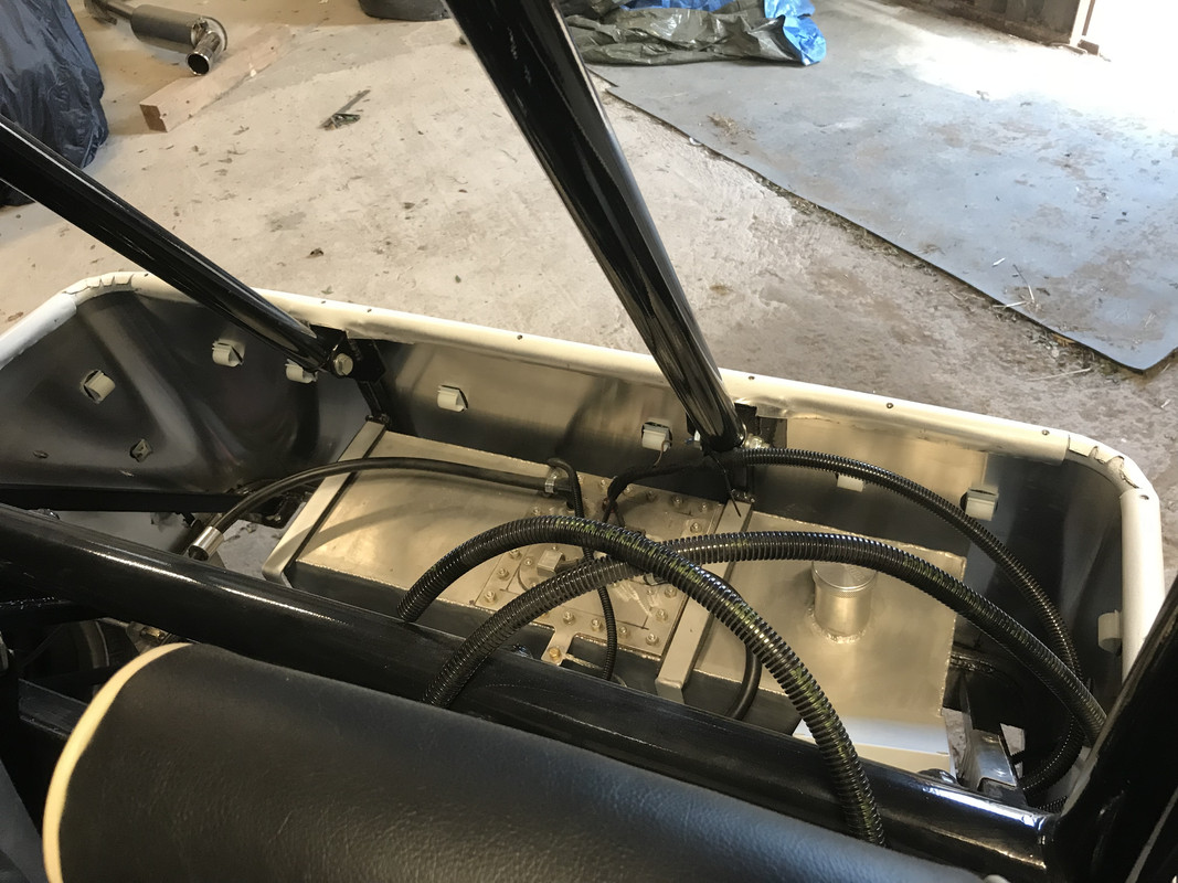

Fuel lines in. Designed fuel tank on solidworks, cut out the aluminium and had it welded - delighted with the results.
Just need to fabricate some mounts for the tank. Going to mount the tank off-set towards the N/S to balance weight out a bit (shown on wrong side on
photo). Also leaves room for a little 5ltr reserve green unleaded fuel container.
Need to mount fuel pump, level sender, breather valve in tank, then hook up fuel lines.

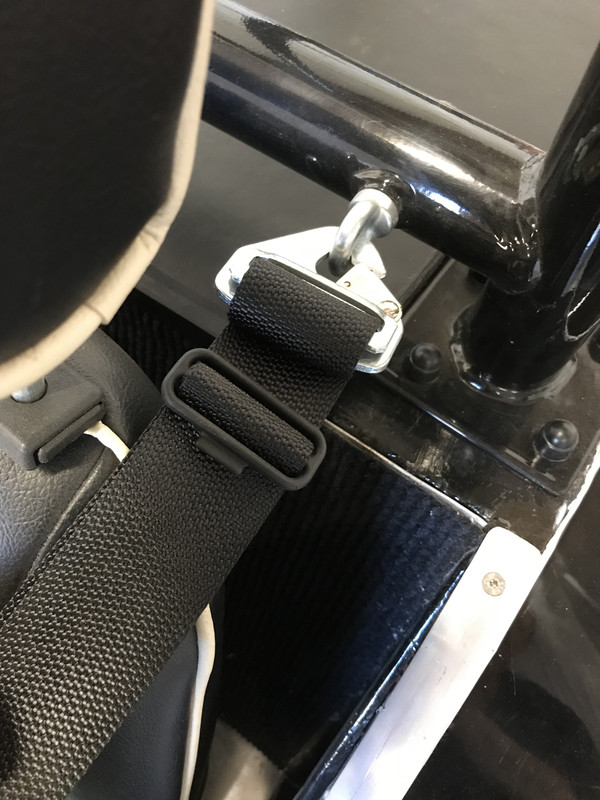

And seatbelt eyebolts fitted with assistance from forum member adithorp.

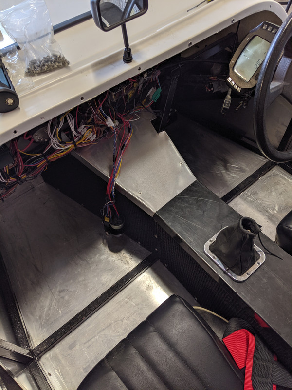

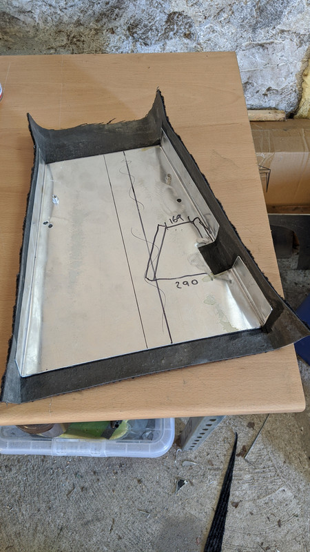

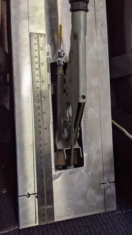

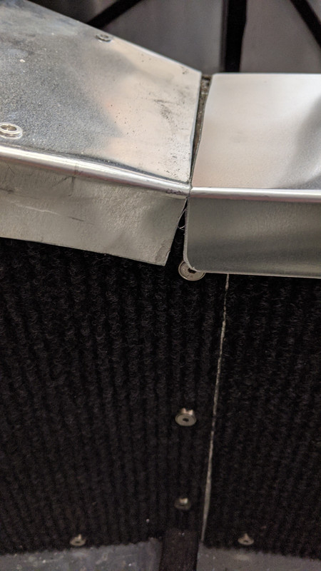

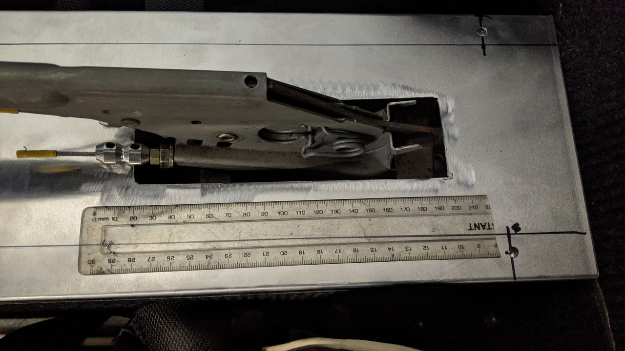

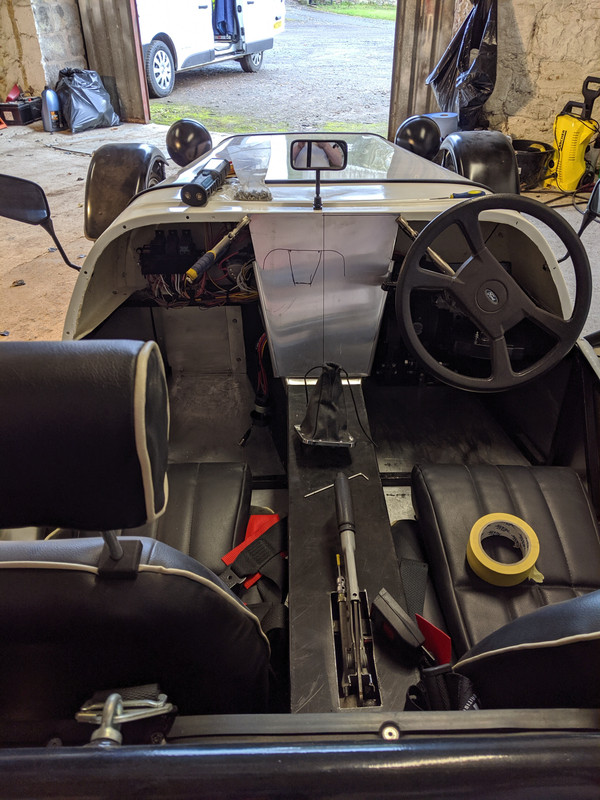

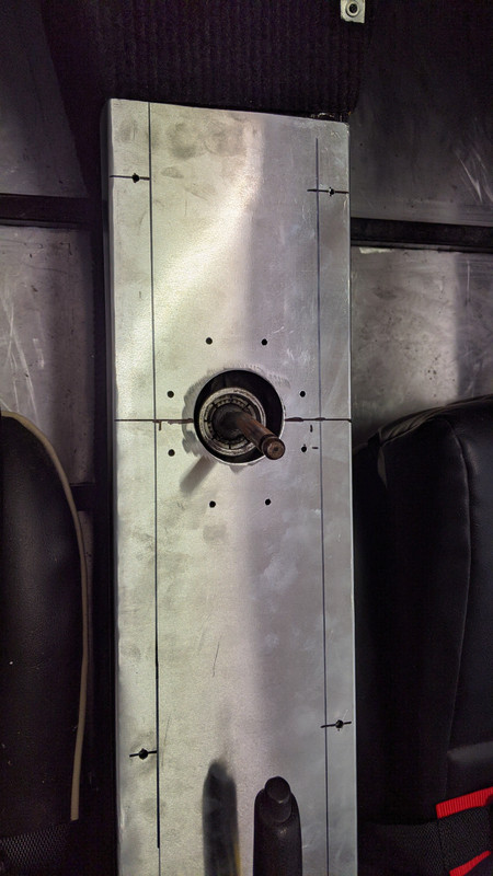

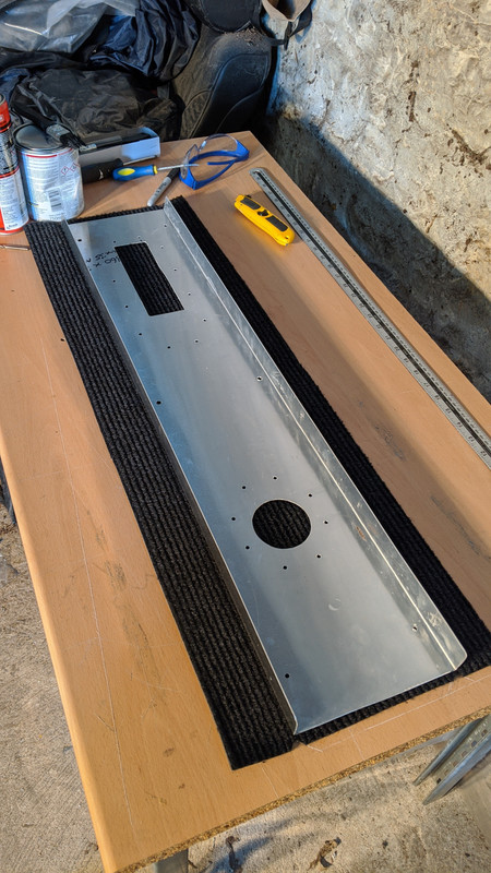

Drivers side tunnel panel fabricated with a little TLC fettling with the precision sheet metal adjustment tool ;-)
[Edited on 31/8/17 by craigdiver]
Been busy over the last couple of days. I had ordered material that was supposed to be similar to the stuff on the interior of lamborginis but

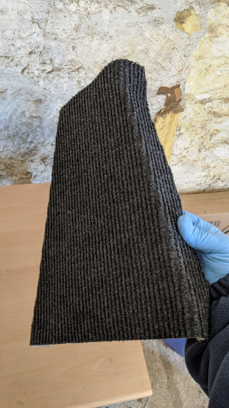

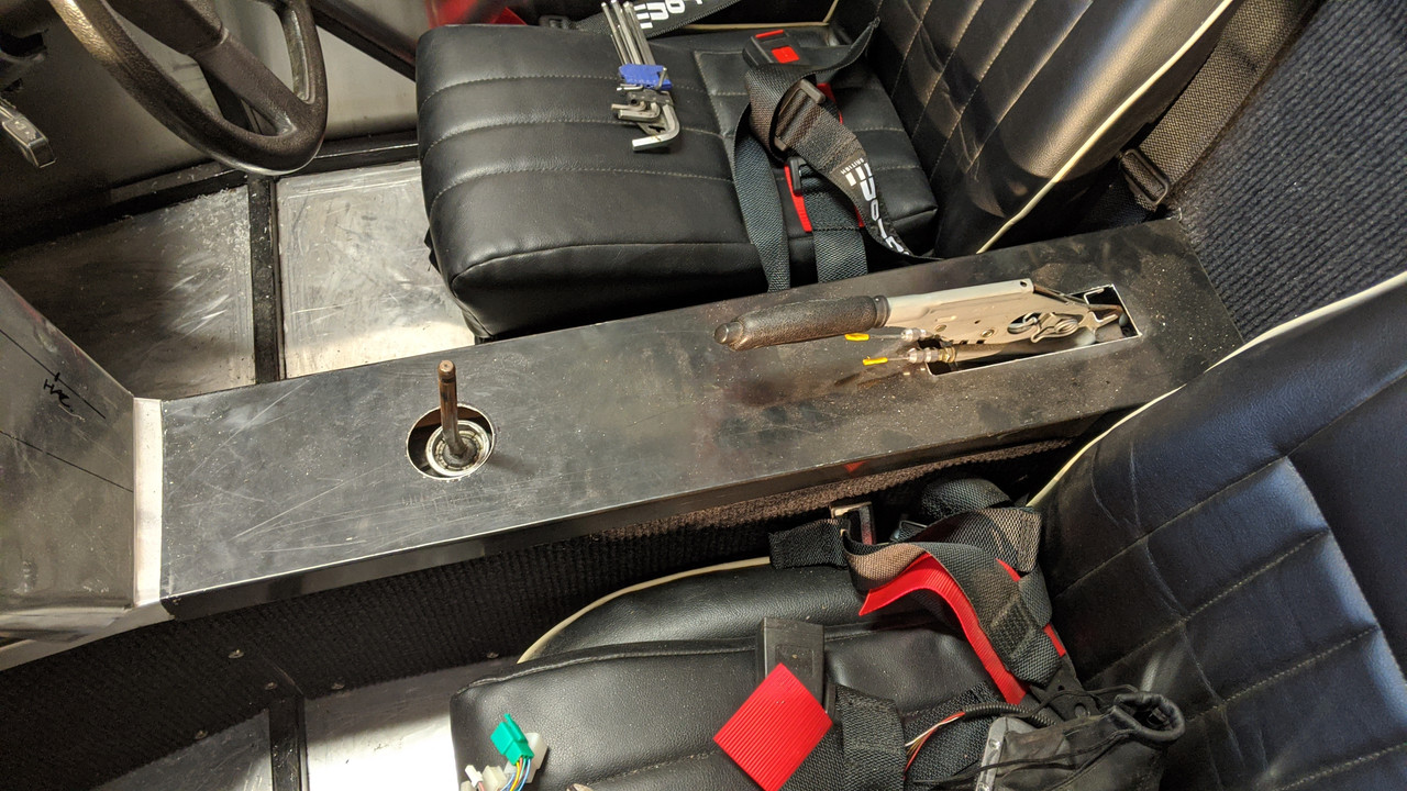

didn't like it so bought black (anthracite) cord carpet from carpetright for £2.99/sqm. Glued onto my rear bulkhead and drivers tunnel panel -
really happy with the finish. Fitted tunnel panel with M5 rivnuts and stainless countersunk hex screws with solid cup washers - again delighted with

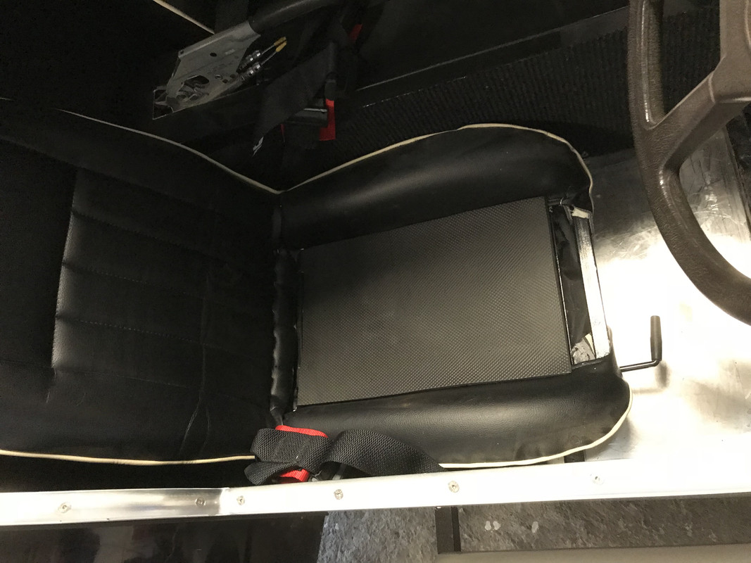

finished look. Fitted drivers seat and sat in the car making vroom vroom noises ;-)
Next job was to assemble fuel pump, level sender, fuel return & rollover vent valve. Went ok but needing to work out how to secure BMW fuel pump
in tank, might need to buy aftermarket submersible pump that can be cable tied in internally.

Finally I sanded down the mk2 escort rack, painted & fitted. Need to measure up what extensions I need.

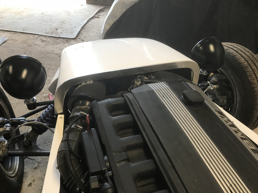

just picked up custom made GRP scuttle to fit my haynes/442E hybrid chassis, just need some warmer weather to get cracking on with the build.
Many thanks to forum user Hugh Paterson for all his hard work making a scuttle from my mock-up, would recommend him for any GRP you are needing for
your build whatever it is.
Happy new year to everyone following my build :-)
[Edited on 31/12/17 by craigdiver]
got drive shaft drilled for speedo magnet and painted. Also test fitted scuttle to make sure had clearance between bonnet line and engine and yipee
(and relief!) have 1-2” clearance. wont quite get a supercharger on there but at least engine won’t be rattling off the bonnet :-)

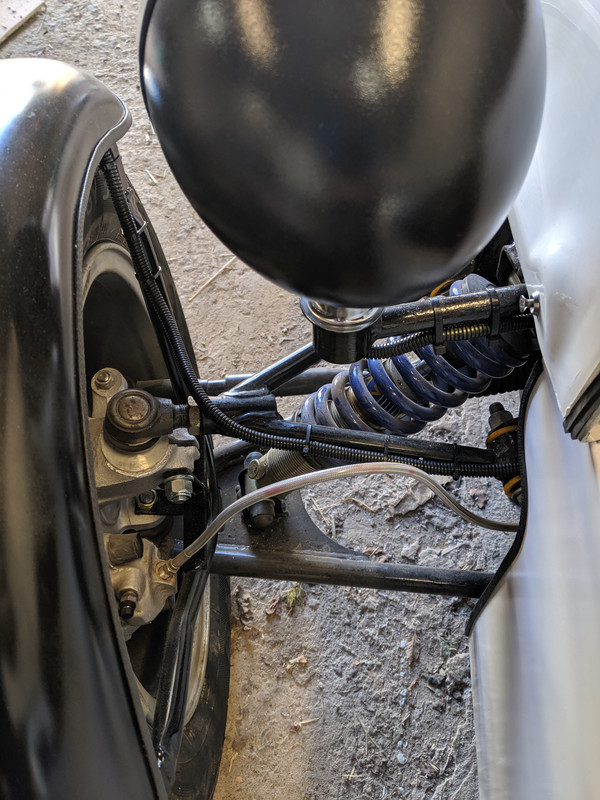

Lots of progress made yesterday and today;
- front suspension and steering completed (then swapped calipers as had them on wrong sides - bleed nipples below inlets!)
- hydraulic clutch test connected to see if clutch operating ok - had a pig of a job bleeding circuit but eventually got it filled with fluid but ran
out of brake fluid. Clutch pedal doesn’t feel great and not releasing clutch - hope it just needs bled properly and is not seized.

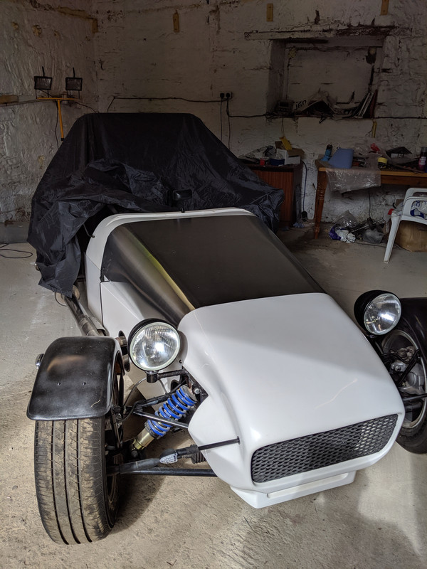

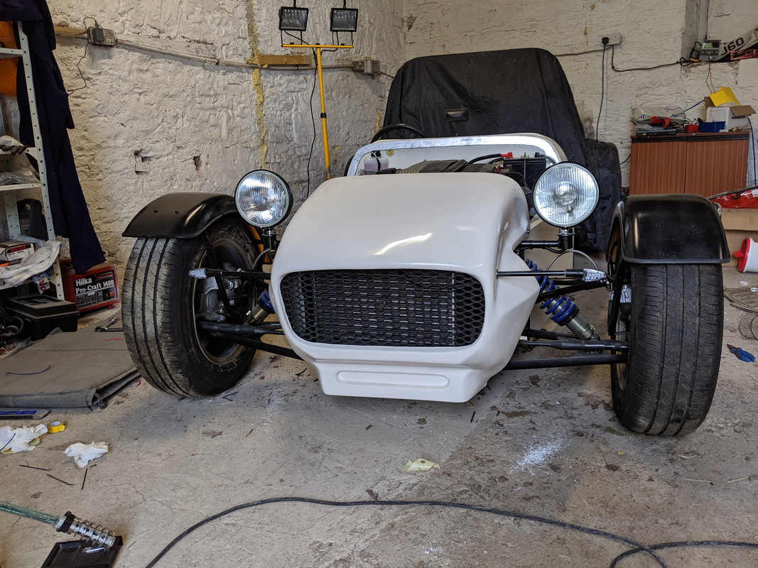

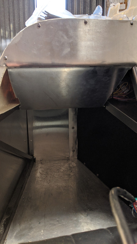

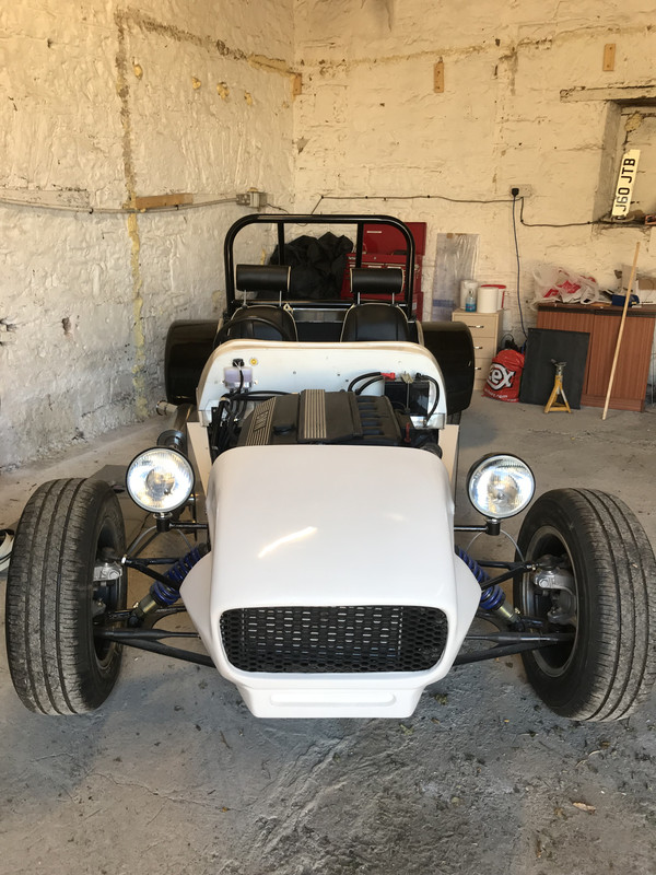

- cut opening in nose cone and made template for grille (any suggestions on what to use for grille?)
- fitted nosecone by hinging at the bottom and securing with couple of countersunk screws in the sides (will they be ok for IVA or do I temporarily
stick in a couple of bolts with plastic dome covers?)
- started reworking fuel tank pump/sender arrangement. Just need to get a bit of aluminium TIG welding done by a friend and then I can complete the
fuel tank - side note; used rubber gaskets previously - they had gone gloopy with the petrol fumes alone - glad I dismantled it or this would have
resulted in petrol vapour leaking. Replaced with cork gasket.
The fasteners on the nose cone. .Can't you.put them on the inside lip so they can't be seen ?.
That's how I did mine anyways.

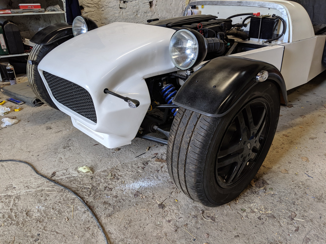

Car lowered onto its wheels for the very first time (and workshop tidied). Running 115mm chassis clearance at the front and 130mm at the rear - looks
great, still smiling like a cheshire cat! I have 75mm clearance from sump to road so will be stiffening front suspension up (by compressing the coil
over springs with big c spanner?)

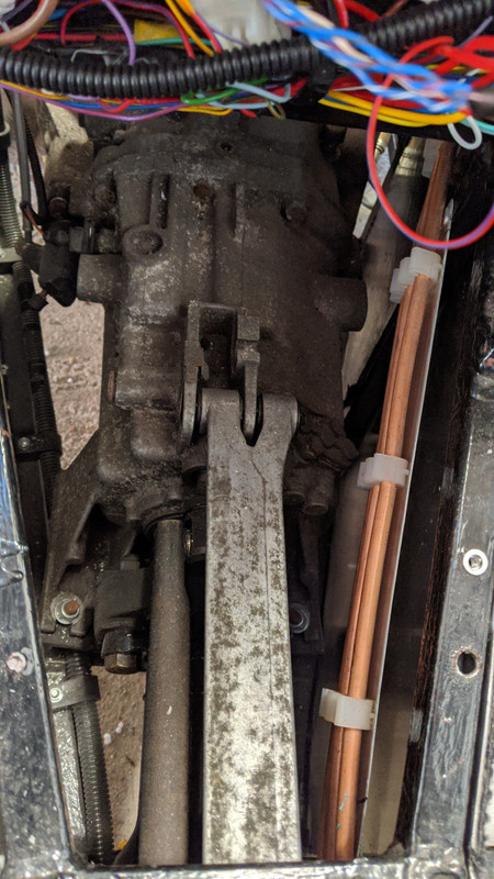

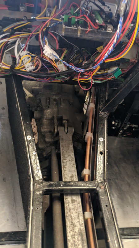

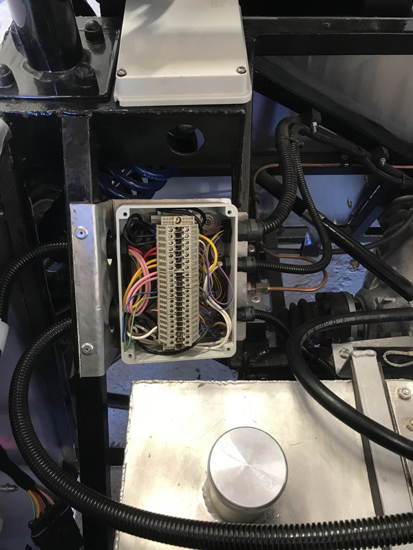

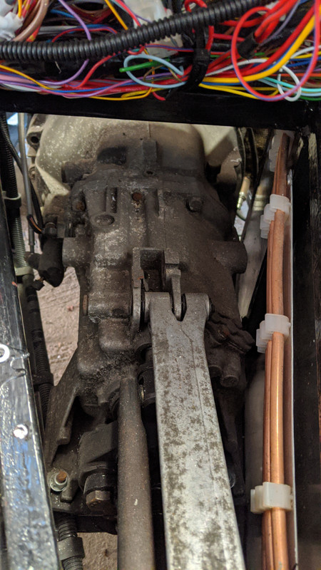

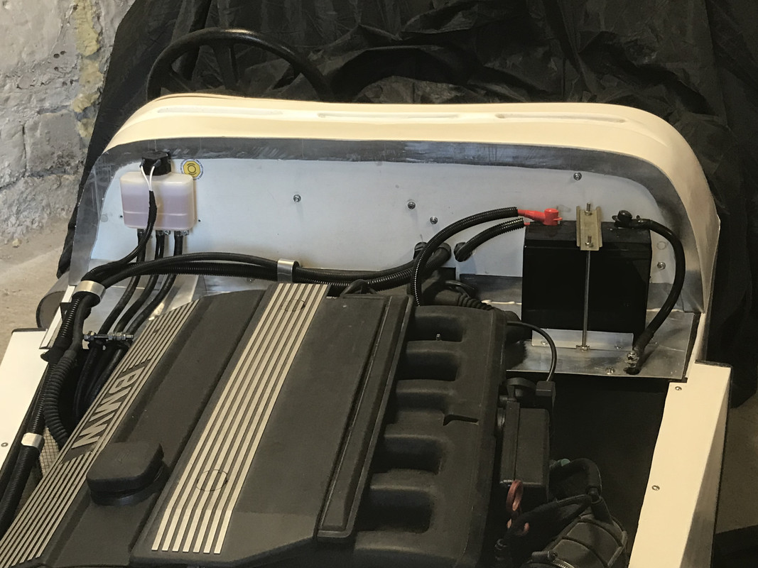

Quite a bit of progress made on electrical system / harness. Interior passengers side and bulkhead complete. made in 2 sections so could be removed
for easy access to gearbox / prop / clutch slave.

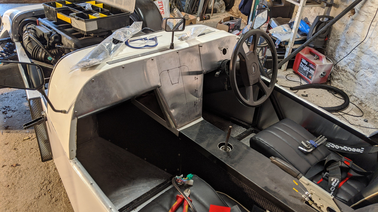

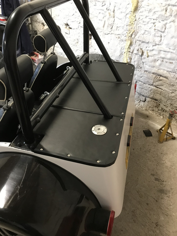

Been busy with the build the last few weeks and onto another milestone - starting to fabricate and fit the bodywork.
A bit of CAD (Cardboard aided design!)
First fit - lots of work to do yet to get it to right shape - wood clamped on to hold it flat whilst working the aluminium.

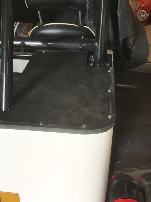

Rear tub finished, don’t thing ill take up metalworking for a living but pleasantly surprised at results!
Bonded on with silkaflex 221 and formed round upper and lower rear tub supports. Folded and rivited at D11.
Had to fit LED numberplate lights / reflectors before fitting panel as almost impossible to get into the rear of them due to fuel tank. (that will be
fun if I ever have to replace them!)

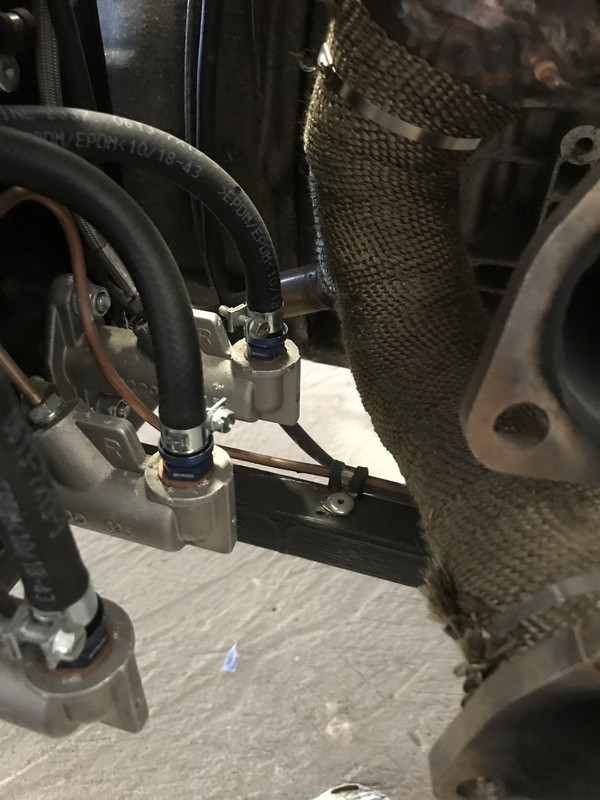

In between fitting the rear tub I have been working to diagnose an air leak causing rough idle. Eventually bit the bullet and whipped the inlet
manifold off. Found perished hoses from CCV to FPR and CCV to dipstick. The hoses were like putty and broke very easily - hopefully that was my issue.
Have ordered complete CCV kit which comes with complete set of vacuum hoses. Also took the opportunity to remove both the purge valve and secondary
air pump valve which are no longer needed.

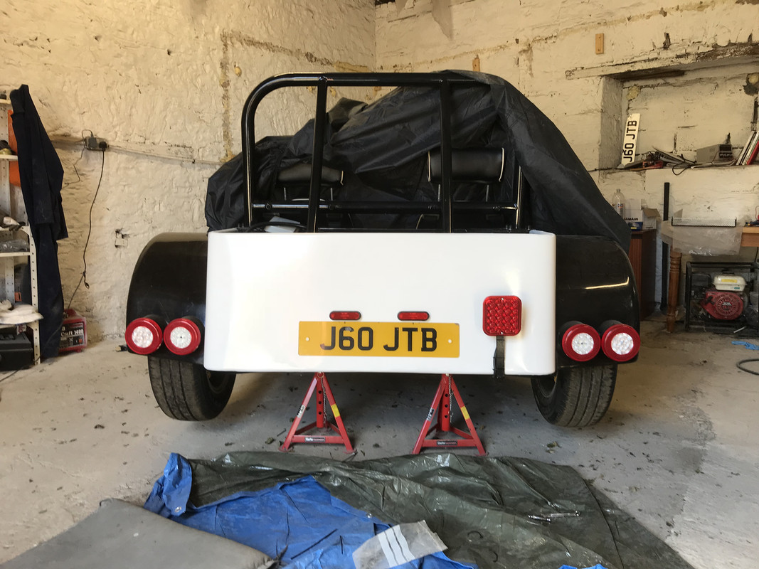

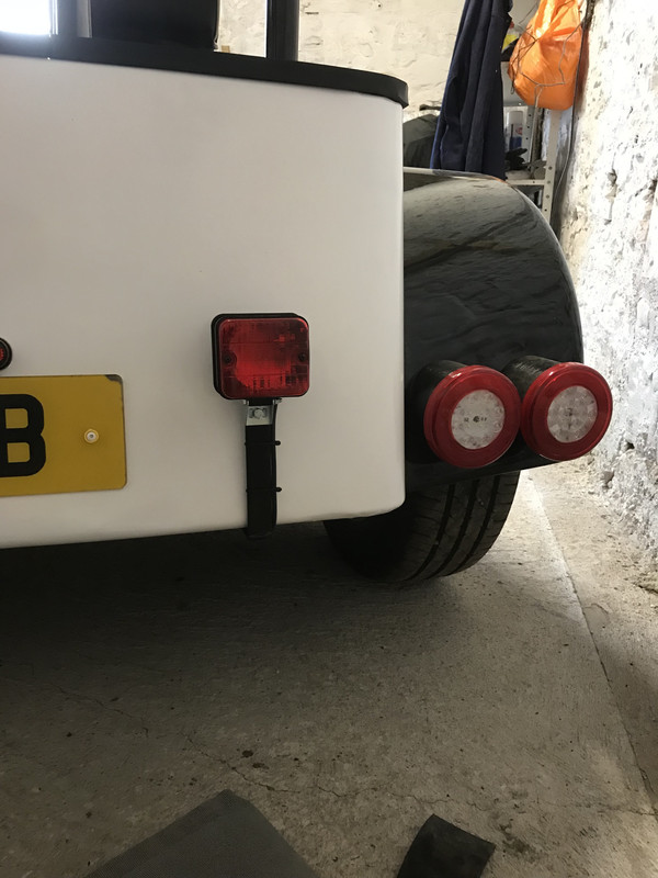

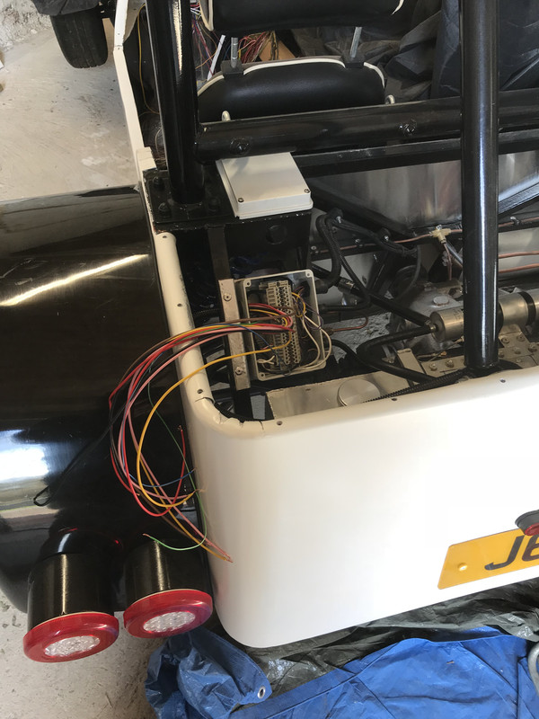

fabricated rear pods for my rear lights out of a bit of drainage pipe. Quite tricky to profile to the compound curves on the rear arches but got
there. managed to get the true on both axis so Mr IVA should be happy with my fog being at the right angle. Just got to paint them black, remove my
shiny new wheels so I don’t drill into them, and fit lights - happy days
Rear lights fitted but will need to fit a fog light on my rear panel for the IVA as don’t have 100mm separation between brake and fog lights. As per
photo below the four lights have a side-light halo, outer lights have indicator and brake, inner lights have both fog and reverse. Was just planning
on using fog on O/S and reverse on N/S. going to paint grey pipe pods black and cover with neoprene rubber as bit of an edge on the back of the light
units.
rear tub cover attempt no.2 done and happy with the result. Just need to find some black rubber trim to finish the edge off. Also got lighting pods
painted.

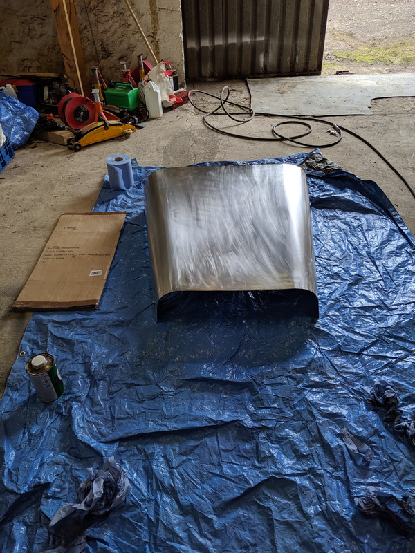

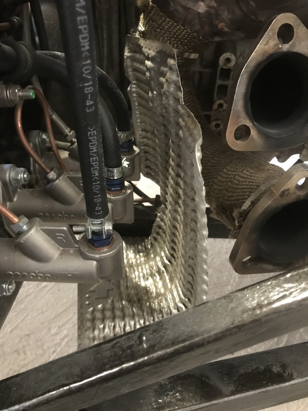

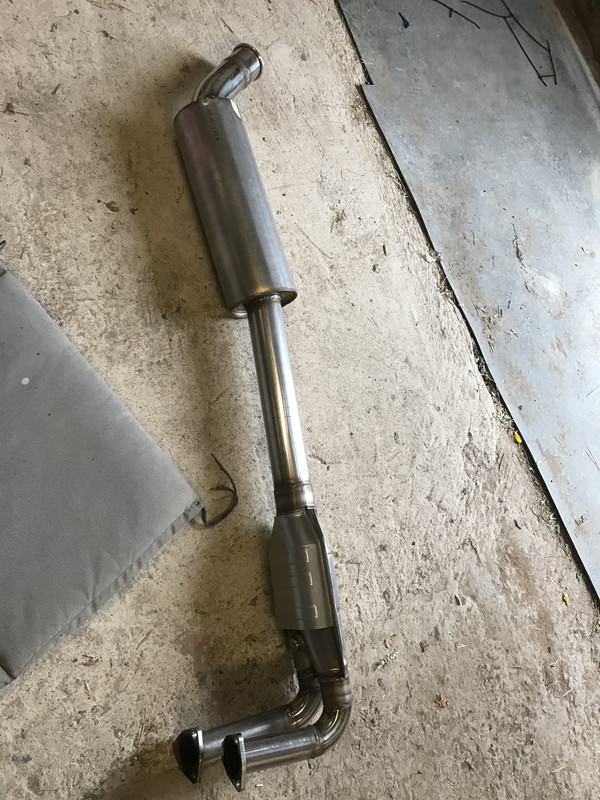

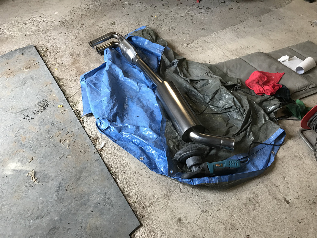

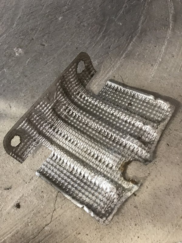

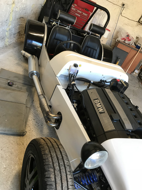

Thats my exhaust welded up today and it sounds amazing. I have left a gap on the 3” pipe to fit a clamp on 12” silencer if it is too loud for IVA but
actually doesn’t sound too bad. The rolled tail pipe protrudes around an inch wider than my rear arch, is that ok?
Will be going to a metal polisher to get brightened up, any ideas how I can make the seams of the silencer IVA friendly (CAT will be completely
wrapped in exhaust wrap so will be ok)
Originally posted by craigdiver
... any ideas how I can make the seams of the silencer IVA friendly (CAT will be completely wrapped in exhaust wrap so will be ok)
There´s a thread where someone request ideas to modify a bike can.
The can has a riveted on shroud that covers these seams.

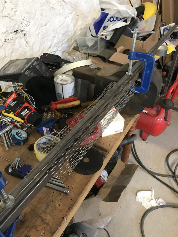

After giving it some thought I think ill roll a bit of perforated material and secure it with pipe clamps on either side of the silencer. I’ll be able to finish the edges of the perforated sheet with safe-edge edging.

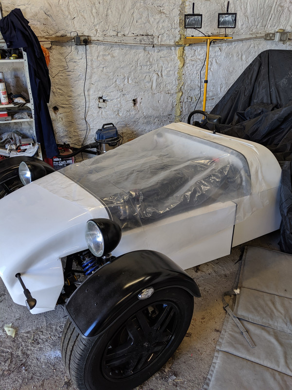

craigdiver - 21/8/18 at 09:13 PMGetting very near getting the car into the spray booth for spraying aluminium panels white to match the scuttle and nose cone.
near side now complete, just got front off-side panel to fabricate then its strip down mask it up and paint!
craigdiver - 21/8/18 at 09:17 PMOnce painted ill fill the seam between the aluminium panels and scuttle with white silkaflex 221.

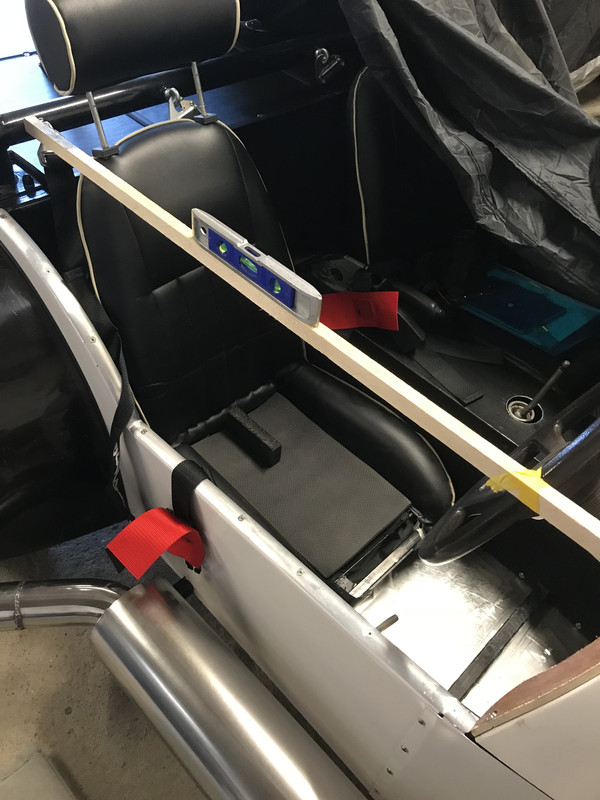

Any suggestions for making a finishing trim for the cockpit side rails? (think I may have asked this already)
Angel Acevedo - 22/8/18 at 02:13 PMquote:
At some point in time I had a small piece of thin (2 mm or so) diamond ali plate that I planned to use as steps.
Was planning to use on the B2 Tubes also...

craigdiver - 22/8/18 at 07:21 PMAnother productive evening, final panel (O/S front) fabricated. The front panels have been designed to be removable as in the future I want to drop an M3 lump in and engine access is tight from above. The tops of the panels are mounted with rivnuts. I didn’t want to drill the bottom rail to insert rivnuts so fabricated brackets which I welded onto the chassis to secure the bottom of the panel. masked off the bottom of the panel and sprayed paint through the brackets to mark where to drill the holes in the panel for mounting. Getting very near painting time.

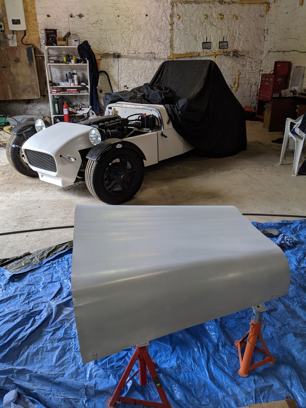

craigdiver - 22/8/18 at 08:37 PMGoing to be getting ready to spray paint the body of the car. I have a full respirator suitable for 1K & 2K paints. Access to a spray booth tent. I have bought 1K white etch primer and 2K paint which has been matched to my scuttle and nosecone colour (by magic at the automotive paints place by them scanning the colour from a piece of gel coated GRP from my nose cone).

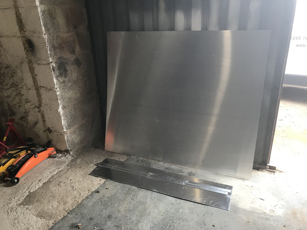

The bodywork panels are all new semi-hard aluminium and were plastic film coated until I fabricated them into the body panels.
I have never spray painted before with compressor / spray gun so have done quite a bit of research and have come up with this process; (please advise if i’m doing something wrong)
1) going to degrease body panels
2) machine sand panels with 320 grit
3) clean and degrease panels
4) mix my white etch primer with 15% thinners as instructed by paint manufacturer.
5) spray only one coat and let dry for 24 hours.
6) ** do I sand it down before first coat of top coat, if so, with what grit?
7) mix 2K paint 2:1 10% ratio/thinners and apply first coat.
8) ** do I sand it down before next coat of top coat, if so, with what grit?
9) will I need to give it more than one top coat, if so, spray second coat.
Fingers crossed that all goes well!

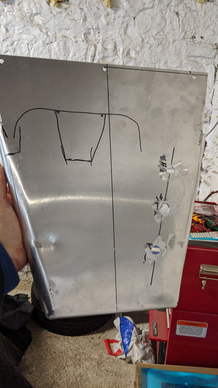

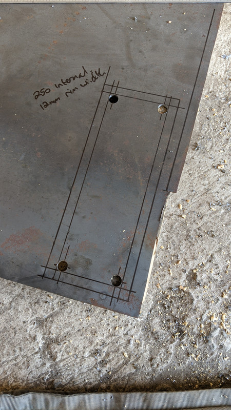

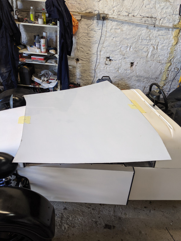

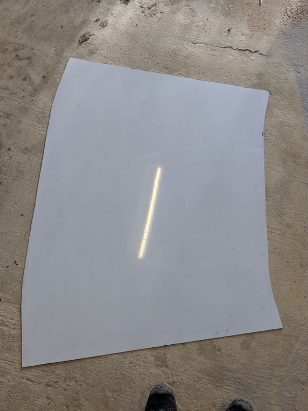

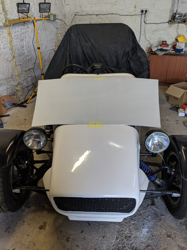

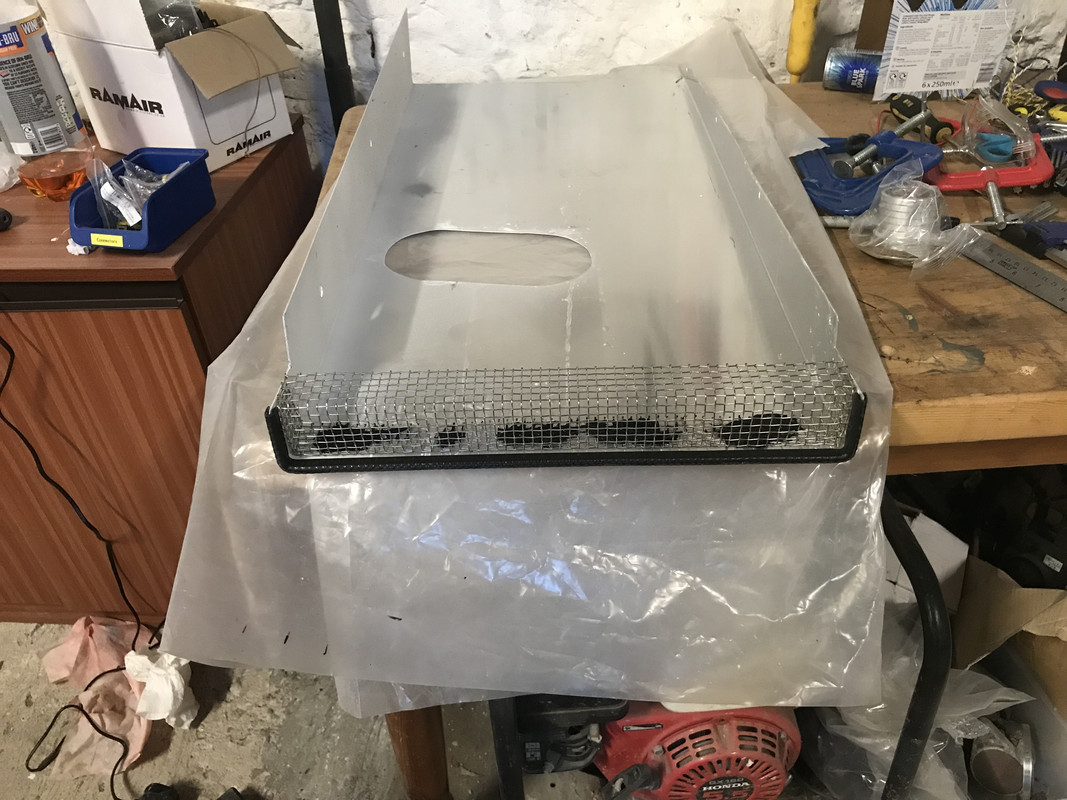

craigdiver - 23/8/18 at 07:07 PMFront O/S panel folded and fabricated. Needed to cut hole for exhaust. well, job done and I was bricking it - It took ages to get that panel just right and now I have to cut a big hole in it for the exhaust. Thank you for your everyones advice to make a cardboard template - but never took it (on this occasion). I went down the technology route and used an app that allowed me to superimpose a photo onto the current camera image. So after making a cardboard template of the hole shape;
1) set camera up in a fixed position.
2) fit exhaust and take initial image.
3) remove exhaust and fit panel.
4) superimpose previous image and mark hole - cannot go wrong as can see ghost image of exhaust.
5) cut hole with perfect result
[Edited on 23/8/18 by craigdiver]

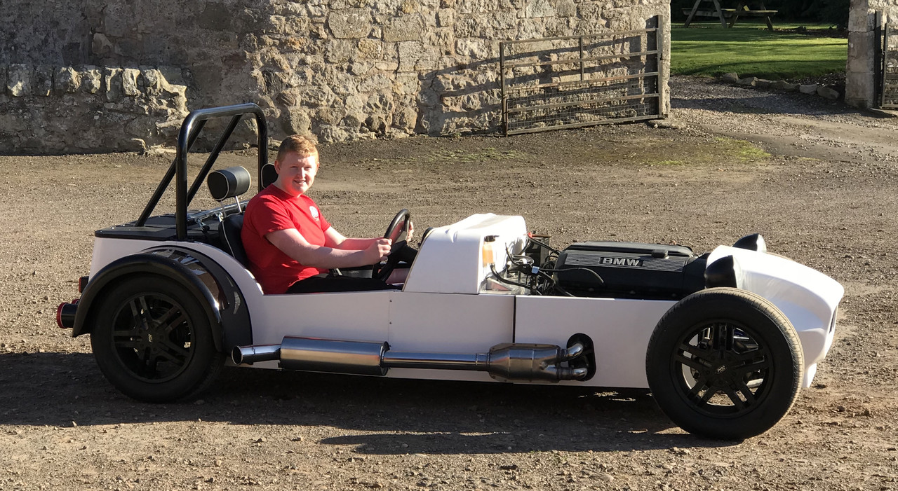

craigdiver - 9/9/18 at 02:56 PMWhile i’m waiting for myself to get my finger out and finish the roadster I treated myself to this.....
It’s an absolute hooligan to drive!

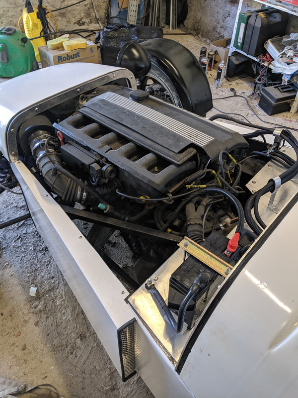

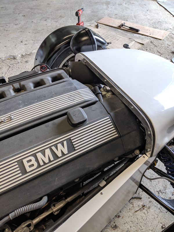

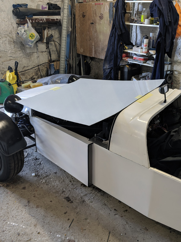

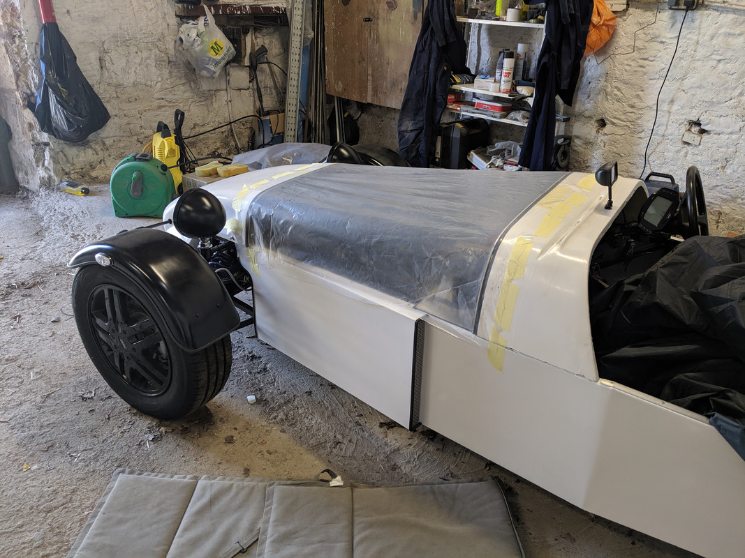

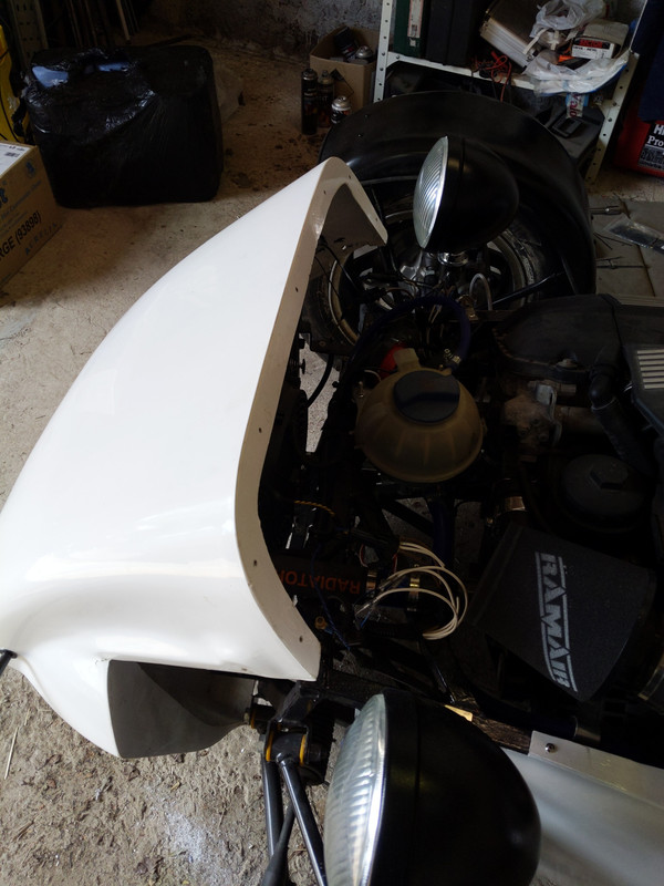

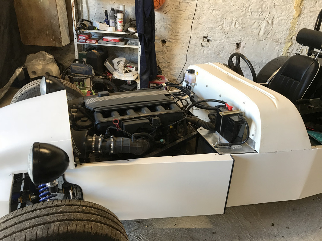

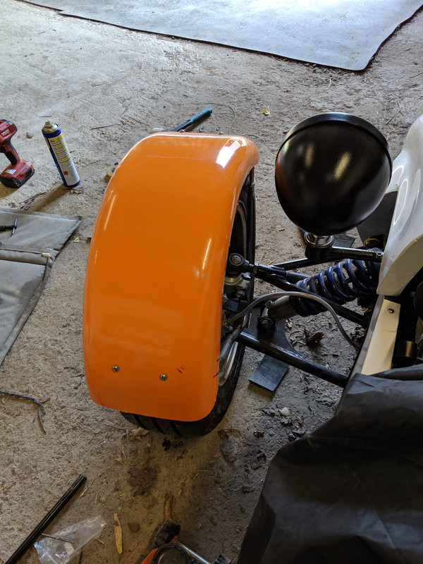

craigdiver - 15/9/18 at 10:14 AMStarted on getting N/S engine panel bolted on. Fabricated side grilles from stainless mesh and hot glued into position. Fabricated bracket to secure cooling pipe at side of engine. Went to test fit panel to see where I needed to put safe-edge on the leading edge and found I had painted the bottom of it rather than the top - complete muppet! sanded down and brush painted, actually looking not too bad. Ill post a pic when paint dry and panel fitted.
craigdiver - 15/9/18 at 12:25 PMFront N/S panel fitted - really pleased with the result. Paint-job questionable but has the built it myself look!

Started on getting N/S engine panel bolted on. Fabricated side grilles from stainless mesh and hot...
At some point in time my engine bay sides will have the same arrangements, but I haven´t thought about grilles there.
What is the reasoning to install them?
Thanks.
AA
craigdiver - 20/9/18 at 02:04 PMHi Angel, purely cosmetic

craigdiver - 4/10/18 at 07:40 PMGot a little bit more done this evening, got clips silkaflexed onto inside of rear tub to support rear wiring harness and fabricated grille for O/S front panel.

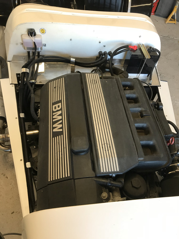

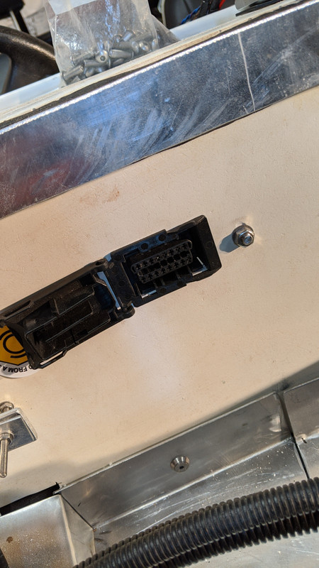

craigdiver - 6/10/18 at 01:00 PMThat is the rear loom fabricated, tested and installed. I have had to add a secondary fog light as the fog lights in my combined units are too close to the brake lights. For show use only, the fog light unbolts easily and a link put in the connector and the fog lights work in the combined units. All lighting circuits have been taken back to the dash as I intend to control lights through a microprocessor so that I can have some fancy effects / strobing rear lights (again for show use only!). I’ll probably add in an accelerometer so that the hazards / brake lights flash quickly if I brake realy hard.
craigdiver - 6/10/18 at 01:40 PMI wasn’t too happy with the proximity of the exhaust to the clutch master cylinder so I adapted a heat shield that I found in a layby a few months ago (funny how you spot something and just know that will come in useful!). Fitted and happy now.
craigdiver - 7/10/18 at 11:57 AMA productive Sunday morning. Section 1 of 3 of rear tub hard cover painted and had trim glued on, fitted to car and pleased with the look. The main event this morning was machine polishing/buffing my freshly fabricated stainless steel exhaust. Used soapy water as lubricant and sanded with 400, 600, 1000, 1200, 1500 and finally 3000 grit. After a clean up with fresh water a whole tube of Autosol was buffed into it with a lambswool pad on the machine polisher. Not quite mirror finish but looks good. Actually pleased with the finish, highly polished mirror finish would be a bit too ‘classic’ for me. I already had a piece of aluminium cut and folded for the transmission tunnel cover. I made up a template for the handbrake hole and cut out with grinder and dressing edges with file. The hole for gearstick was cut with a holesaw. Think ill cover it with some padded black vinyl. Since everything going well I decided to have a go fitting the half-round aluminium profile to the passenger side cockpit edge. Didn’t have a countersink bit so my countersunk hex machine screws are sitting proud but will pick up bit and countersink holes.
craigdiver - 15/10/18 at 05:42 PMHad a day off work today so got a few jobs done. Firstly dismantled brake pedal / bias bar assembly and fitted locking kits. Reassembled and added the obligatory ‘do not adjust blah blah’ sticker. This allowed me to fit side panels and the exhaust. Oh what fun connecting the exhaust to the downpipes, few war wounds later the exhaust is on. Next I got it off the axle stands and couldn’t help myself taking it for a spin round the yard (I can just feel it wants to go faster!). Next job was to fit the half-round aluminium trim on the drivers side cockpit edge. Finished off wiring brake light switch and reservoir level switch into loom and fabricated a couple of brackets to secure.
I’m acquiring some thin stainless sheet later this week that I intend to fabricate into a bonnet. Not decided whether to paint white or wrap with carbon fibre effect wrap.
Issues I had today is that the rear lights are only 335mm off the ground and need to be 350mm for IVA. Fortunately i’ve not set my rear coil-overs yet and should be able to raise car up 20mm (are lights measured with anyone sitting in the car?).
Also, will I need to cover the harness to eye connections?
SJ - 15/10/18 at 06:36 PMLooks great - have to say your wiring is super neat and the engine bay looks amazingly uncluttered.
craigdiver - 15/10/18 at 07:47 PMquote:
thank you, its a mix of OCD and being an electrical engineer!
craigdiver - 16/10/18 at 06:32 PMDid the last couple of jobs to complete rear end. Rear tub covers complete with trim. Also, rear fog light replaced with one with both ‘E’ and ‘F’ markings.

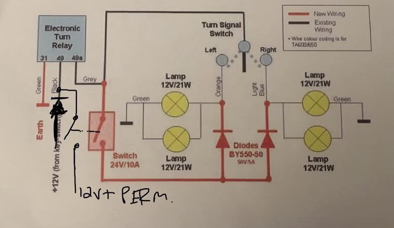

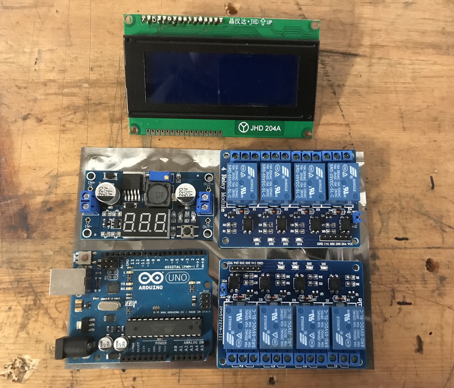

craigdiver - 21/10/18 at 02:09 PMA bit of electrical work today. Been working on a design for indicators & hazzard warning lights and set up on bench to test. Two live feeds, one switched from ignition, one permanent (for hazzards). 3 diodes, one electronic flasher relay and one DPST dashboard switch for hazzards. Also started on the electronics for microprocessor control of rear lights for special effects. I have also included an accelerometer to measure emergency braking which will flash hazzards quickly. The microprocessor will also control fog light function which will make the logic simple with any changes being a simple change to a few lines of code.
craigdiver - 21/10/18 at 02:12 PMAs a side note; I do not recommend complete microprocessor control of rear lights without some robust purpose built automotive system. I will be achieving fail-safe integrity by controling the lighting circuits through banks of n/c relay contacts. When the microprocessor wants to take control of the lights it will switch the relays and use high speed mosfet switching to perform the desired effects.

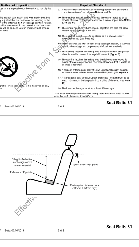

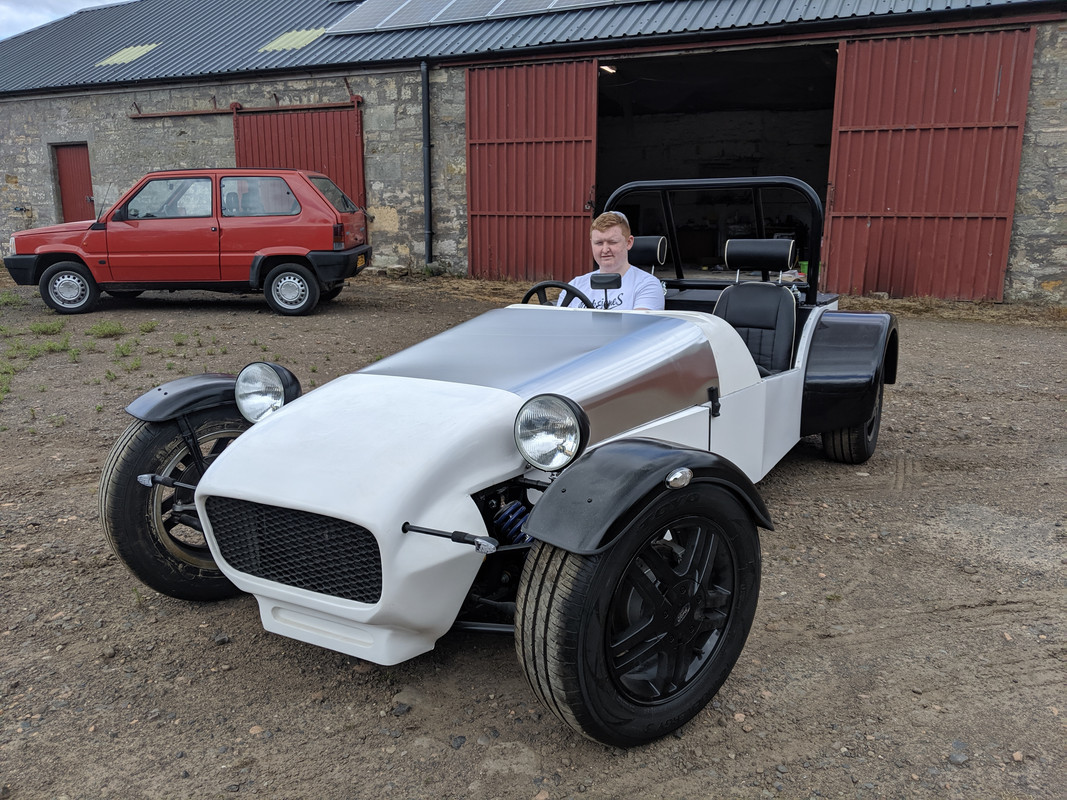

craigdiver - 27/10/18 at 04:51 PMMy son Matthew who is learning to drive couldn’t resist having a drive round the yard.
Angel Acevedo - 27/10/18 at 06:05 PMquote:
From this picture I think you´ll have problems to comply with Harness anchor points requirements.
Or do you have a plan already?
craigdiver - 27/10/18 at 06:58 PMquote:
[Edited on 28/10/18 by craigdiver]
Angel Acevedo - 27/10/18 at 08:40 PMI´ve done some search and now I think that what I wrote it´s just hearsay.
Some manufacturers state Mininmum amd maximum "recommended" angles, but even then the angles beyond that are not listed as non acceptable.
Regards.
AA
craigdiver - 27/10/18 at 09:01 PMquote:
Regards.
AA
thanks Angel, I appreciate your advice
craigdiver - 28/10/18 at 11:25 AMAngel, you were right, my upper anchorages are only 400mm above the reference point (as per IVA manual), needs to be at least 450mm. Will need to rework the roll hoop and pay to have powder coated again :-(
Angel Acevedo - 28/10/18 at 02:21 PMquote:
Sad, but I think that´ll be cheaper than a re-test anyway isn´t it?
craigdiver - 29/10/18 at 05:32 PMI am guilty of not reading then re-reading the IVA manual and understanding it very well. I made the mistake where I never realises there are two sections relating to seatbelts and their anchorages. Fortunately, my mistake had a relatively straight forward fix. I had never planned my build so I could measure a reference minimum dimensions between seat base and upper anchorages. To rectify this I am removing the very thick seat squab and replacing it with something much thinner. This has an added bonus in making the seat back taller which may have been an issue.

craigdiver - 5/4/19 at 10:45 AMBeen putting this job off as not sure how to form the supports accurately or what clearances I should use. Any advice very welcome. (Will be painted black to match rear arches - white / black / orange colour scheme probably bit too much!)
[Edited on 5/4/19 by craigdiver]
craigdiver - 5/4/19 at 02:07 PMWell that wasn't too bad, bracket off and on a dozen times but looking and sitting not too bad. Now the other side to do. Need to drill holes to mount side repeaters then remove them to paint brackets and wheel arches black.
craigdiver - 6/4/19 at 02:12 PMWas nothing to worry about at all, relatively straightforward, however, don't think I should give up my day job to become a metal-worker! Going to remove them now and paint brackets and arches black.

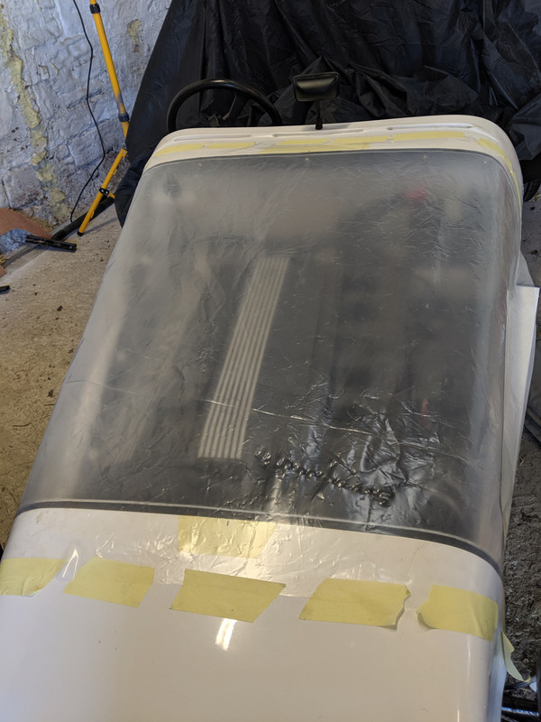

craigdiver - 27/5/19 at 11:03 AMElectrics done and now onto bonnet. Roughly have an idea how this will go together but will definitely be making it up as I go along! Firstly as neither my nose cone or scuttle has and bonnet support lips I am having to fabricate something myself. I have cut aluminium supports slightly smaller than the profiles on the nose cone and scuttle. I then cut some rubber and sandwiched it. Nose cone done and pleased with the result. Scuttle next which will be trickier as the majority of my wiring is under there. Once that is done I'll make a bonnet template using polythene and cut out of sheet aluminium.
craigdiver - 27/6/19 at 05:56 PMBit more work this afternoon on sorting out a custom aluminium bonnet. Support made from aluminium and rubber and fixed onto scuttle.
Got polythene sheet to use to make a template for cutting the aluminium to size prior to bending it into shape.
Got a concern about the wiring for the side repeaters on my cycle wings. Run it through kopex trunking and cable tied onto wishbones. Not sure Mr IVA will like this but cannot see any other way to do it. Any suggestions? Or should that be ok?
[Edited on 27/6/19 by craigdiver]
big_wasa - 27/6/19 at 06:34 PMHow did you go about bending the wing stays please ? I am looking at mine and they must be 20mm x 4mm+ thick
craigdiver - 28/6/19 at 11:58 AMNothing technical, vice and a heavy rubber mallet. Mine were quite tough too. (I bought them ready made, just needed slight alteration)

craigdiver - 29/6/19 at 10:35 AMBonnet taking shape but will need to leave it like this for the moment until I can get another pair of hands.
craigdiver - 6/7/19 at 06:03 PMGreat day, with the help of my son Matthew we managed to get the aluminium bonnet formed and IVA friendly rubber bonnet catches fitted. Involved a great deal of fettling but got there in the end and really pleased with the result. Just need to paint it now.

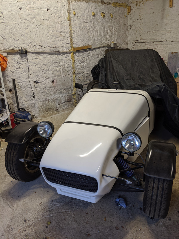

craigdiver - 10/8/19 at 03:22 PMJust moved house so this is the first opportunity to start painting my newly fabricated bonnet. Had to do some research as been ages since painting the body. Prepped bonnet by degreasing then roughing up with 800 grit, degreasing again then a thin coat of 1k etch primer. Went on ok.
J666AYP - 10/8/19 at 03:33 PMBloody love that car!
starterman - 10/8/19 at 06:28 PMI might be wrong but I beleive that for IVA the edges of aluminium panels need to be rolled.
Mike
craigdiver - 5/9/19 at 05:59 PMThank you.
craigdiver - 5/9/19 at 06:03 PMThanks for the advice Mike, promise you it's much appreciated. Its not finished yet, I've got rubber profile to bond on which will bridge between the bonnet and nose cone / scuttle which will protect from sharp edges. Also got safe-edge profile to go on the rest.
Mike

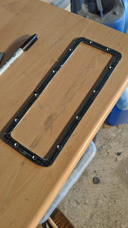

craigdiver - 2/11/19 at 06:58 PMFinally got rubber seals bonded onto my bonnet and safe-edge on sides. Looking good (don't look too closely at the paint job!).
My son, Matthew, gave me a hand today to start the dashboard. Went very well. Fabricated aluminium pieces to cover tapered front section of transmission tunnel, centre dashboard panel and passenger side dashboard piece.

craigdiver - 23/2/20 at 04:38 PMHad a busy weekend. Dashboard and interior. While dashboard was out fitted OBD socket to bulkhead. Also fabricated base for handbrake gaitor and got it undercoated. Found out my nearest IVA centre is Livingston. Will aim to book it in October time so if it needs retest I will have until March next year to fix.

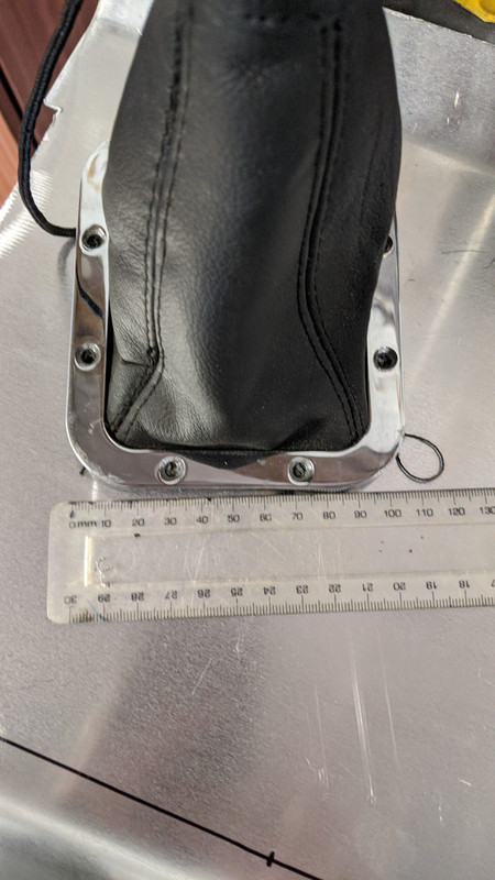

craigdiver - 2/3/20 at 05:39 PMSpent last couple of weekends working on dash panels and other interior stuff. Most of it came together this afternoon leaving me with what looks like a finished dashboard. Got a couple of bits of trim to add to the lower edges of the scuttle then that can be ticked off the list.
