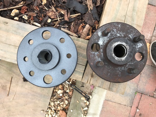

front flange cleaned down, drilled 4no 14mm holes not much weight loss but they look
a lot better with the 4 extra holes, used etch primer, metallic black paint, and pu lacquer

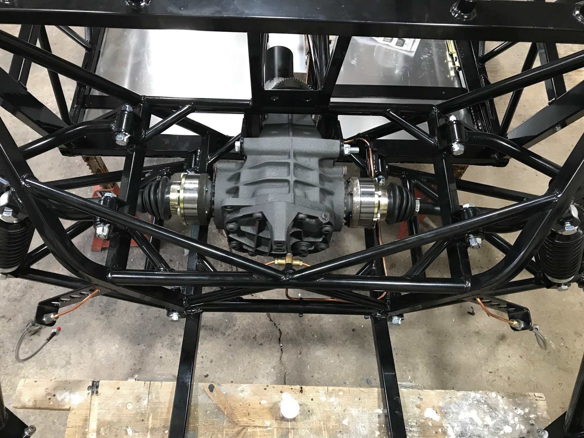

Rear end all complete, waiting on a few more parts
Fuel tank, lights ect but drive train is all done and breaks Bled
