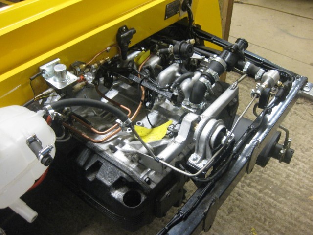

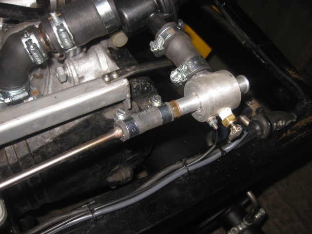

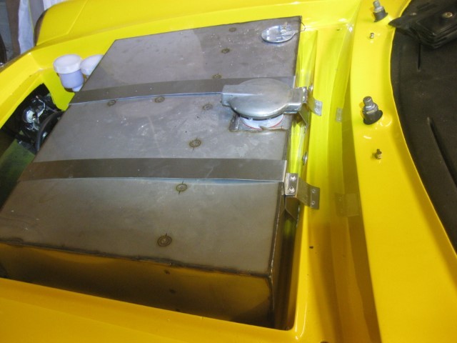

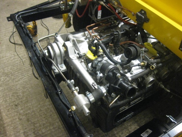

With advice from 40 inches and Nick 205 I'll try to load some photos. They should relate to the text in my previous post.
John Bonnett
| posted on 13/5/18 at 09:46 AM |
A few more pics, full size this time.

Looking good John, that engine looks made-to-measure!

It really does look as if it were meant to be. Same weight and dimensions as the Imp engine and uses the same unmodified mounts.
