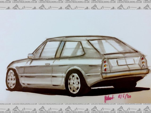

ettore bugatti
| posted on 9/6/20 at 10:06 AM |
Are you going to widen the track a lot? I would think a Fiesta mk5 screen is way too wide and too tall.
I can dig some rough dimensions of the Citroen Ax screen if you are interested.
I couldn't resist to sketch an idea out.
[Edited on 9/6/20 by ettore bugatti]
John Bonnett
| posted on 9/6/20 at 12:04 PM |

I could do with your artistic talents; a superb bit of drawing, and yes that's pretty much what I'm hoping to achieve. I really like how
you've captured such an aggressive stance and brought the whole design bang up to date.

| posted on 12/6/20 at 12:11 PM |
that looks like a Reliant Scimitar!
John Bonnett
This is what I'm aiming for and EB got it spot on with his sketch which actually blew me away.

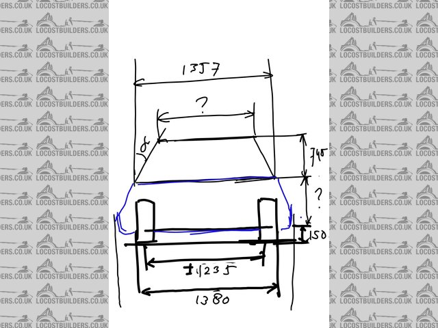

ettore bugatti
| posted on 12/6/20 at 06:46 PM |
Although the Beta HPE was not designed by Guigiaro it has very much strong resemblence to Italdesign designs, lovely theme to sketch in. Your project
is not far removed from 2+2 rwd coupe I have been working on in terms of packaging.
  Width
I think the screen will caused the wheels to look lost in the body if you take in account the space the side glass need to go when you wind them down.
See the sketch for clarification.
Looking at various blueprints, I recon the screen width should be very similar to the track.
I guess wheel spacers or lower offset wheels might work.

ettore bugatti
| posted on 15/6/20 at 11:22 PM |
The photo is slighty distorting the proportions, the sketch needs a proper scan.
John Bonnett
| posted on 16/6/20 at 07:28 AM |
This is the result of superimposing the Fusion sketch over a photo of an HPE and drawing the outline. The rear wheel arch on the HPE is further back
than it will be on my car but apart from that, it all lines up well.
SJ
| posted on 16/6/20 at 10:21 AM |
The proportions look good!
SJ
John Bonnett
| posted on 16/6/20 at 11:10 AM |
Thank you. It does look promising and I'm hopeful that it will work. Whether I can build it though is a different matter entirely.
ettore bugatti
| posted on 16/6/20 at 05:05 PM |
Ended up with a new sketch since something wasn't quite right with the greenhouse on the other sketch:
John Bonnett
| posted on 16/6/20 at 06:16 PM |
I'd be pleased if I'd made that. Nice drawing thank you EB
