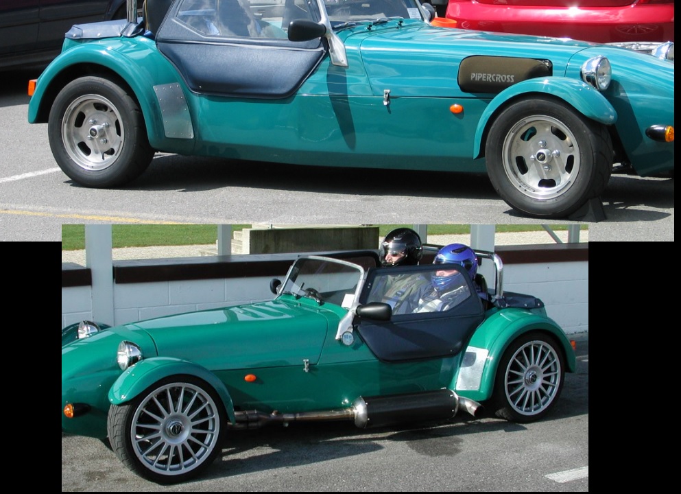

I do have a question? When I bought the car he threw in six spare wolf race wheels and tyres, and was adamant the car handles better without the low
profile ones, just wondered if anyone has a view?
Will probably put the redundant set up for sale eventually.

CosKev3
| posted on 30/12/17 at 04:34 PM |
Yeah they handle and drive much nicer on smaller wheels with higher sidewalled tyres
petroldiaries
| posted on 30/12/17 at 05:02 PM |
Cheers mate, I might get these wolf race wheels all polished up then....Thanks for taking the time to reply!!
CosKev3
| posted on 30/12/17 at 05:06 PM |
I think smaller wheels look better too,suite the car better.
Downside if you go to 13 inch wheels tyres aren't as cheap as 15''s
They look like 17''s in your pic? The ride would be very harsh on those too
