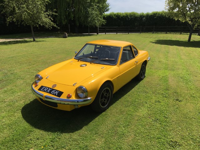

To complete the story I just wanted to share a photograph of the finished car which is now in the hands of the new owner.

Looks great John especially in the yellow.
Where does the new owner live?
Alex
John Bonnett
| posted on 23/7/19 at 09:22 AM |
I love the colour too Alex. It's Porsche Signal Yellow.
The BMW conversion is a delight and is becoming very popular now with the owners of Imps and Imp derivatives. It's a very cheap way to a
reliable and usable 100 and 130bhp depending on which engine is used.
The new owners are a father and son. The son lives in Exeter and I believe the father is in the New Forest area perhaps not too far from you.

AlexXtreme
| posted on 23/7/19 at 12:22 PM |
Hi John,
Saw this car at a local motor event just a couple of weekends ago!
Chatted to what was must the father who lives near Romsey, just a few miles from me.
I had a good look round and he started the engine up for me and I was amazed how sweet it ran! He said it was a 100hp I think.
I especially like the finish inside with those seats - good work.
Have you posted this picture up on the Ginetta Owners club forum?
Alex

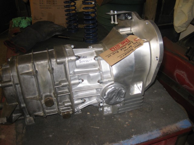

Now that is a small world Alex. They are a nice couple of chaps and the car has gone to a good home where it will be looked after and enjoyed.
The engine I fitted is the K1100RS which gives 101bhp. Clark Dawson an Imp specialist masterminded the conversion and he designed a cnc machined
bellhousing made from billet aluminium and a choice of adaptor plates to suit the three engines in the K series. Included in the kit is a flywheel and
clutch with a concentric release bearing. All beautifully manufactured and the whole thing fits together perfectly.
John Bonnett has attached this image:
