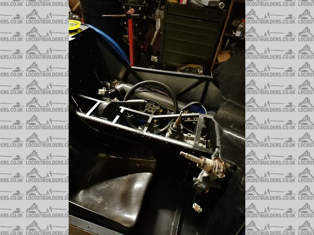

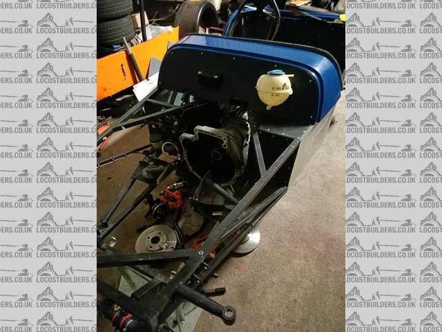

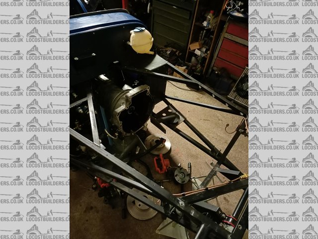

So been doing some playing with the car.
Some good news, some not so good,
Found out the exhaust can is a genuine Westfield carbon fibre item worth £500
However the car is now stripped down to a pretty bare chassis.
Got a good few bits of previous owners work to fix...
For some reason the engine has been moved from the factory Talon position and the new gearbox and engine mounts are horrific.
The roll cage was just drilled and bolted through the top chassis rails no reinforcing plates.
The Steering column is in the wrong position and wonky.
The exhaust mount needs a crush tube adding.
Pedal box is useable but I have a bias bar box here so that's going to get swapped out.
Then it's turbo kit and wiring!!
