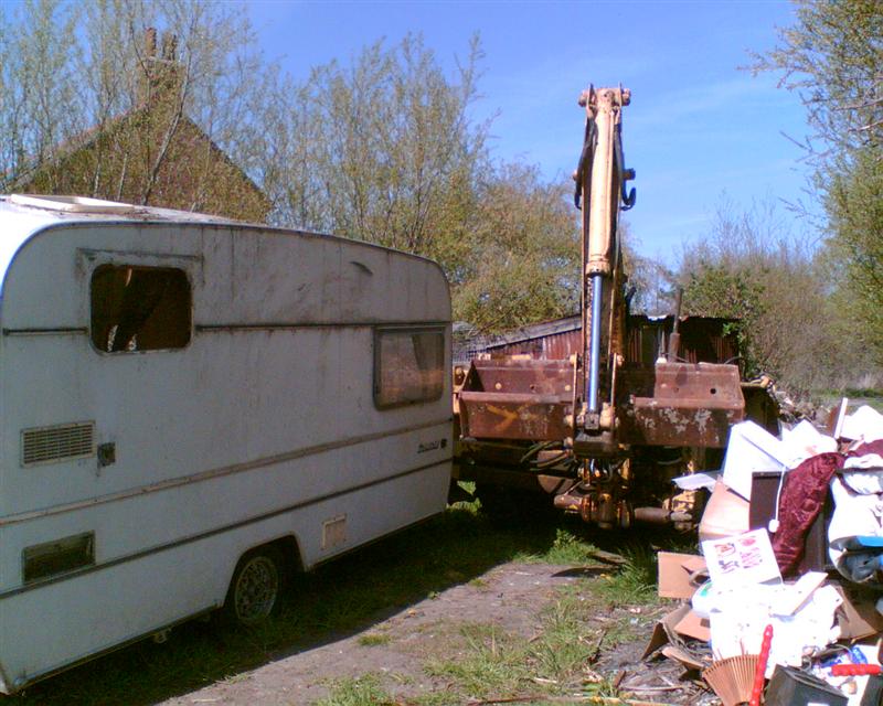

I know its been discussed on here many times before and I have done a search but I can't find the basic info that I need.
I've just bought a lovely caravan for the pricely sum of £40.
Lovely isn't she...
I'm going to do the obvious and turn it into a trailer. I've heard that the ali of the sides and lid of the van are ali and can be valuable
as scrap. how do I get these off without wrecking them?

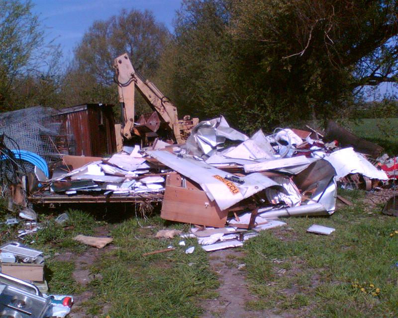

I took my caravan apart with a small hand axe! Just work your way along the glue lines chopping away merrily until you've got a pile of ali
sheet lying there. I took all the internal wood and windows out first which made the whole thing a bit flimsy and dangerous, but it was a whole load
of fun and netted me £54 in scrap value.
Great fun...
Jus rip it all apart with a hammer then strap the ali to the chassis and use that to tow it to the scrappies.

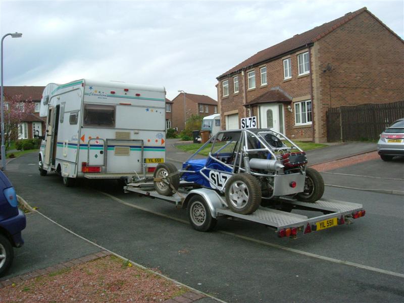

trailer
This was once a caravan, I used 40x40x4mm angle to make the beds welded on to the original chassis.
i know some people weld in some extra channels to beef it up but i didnt see it necessary as its not carrying that much weight. Although i have had
just over a tonne on there. Tows perfect.
the only thing i would change is the bed is highish so the weight is high but its not a problem when towing just needs longer ramps. So try and get
you bed as low as you can which is ahrd with the axles etc.

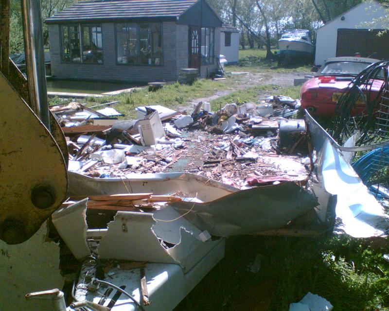

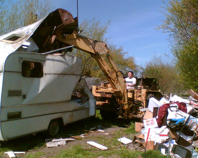

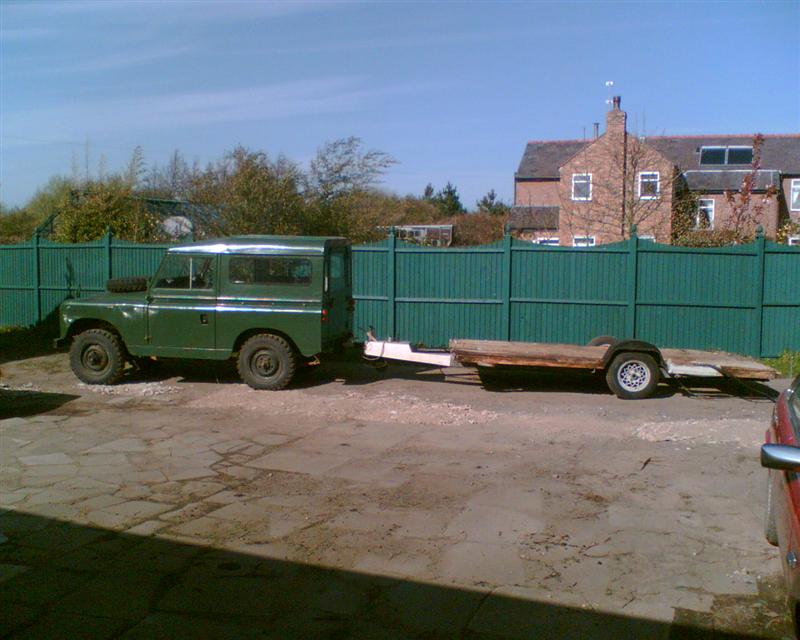

Quickest way:
Is now:
