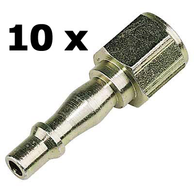

Krismc
posted on 29/3/11 at 08:07 PM Reply With Quote
Update........
Plumbed like this
Now i just need one of these welded.........
Onto this long silver section of pipe in the drawing?
