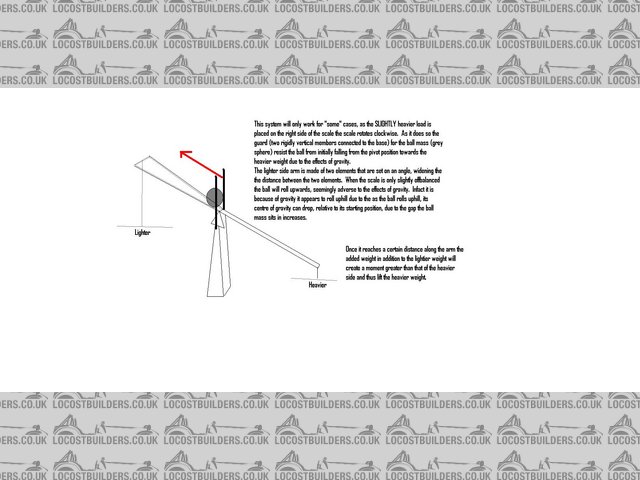

| posted on 3/2/06 at 06:39 PM |
All a bit confusing to me but a fiend of mine came up with this. he says the idea is flawed and can be improved on, but should work. Hope the pic
works not posted pics up on here before.
