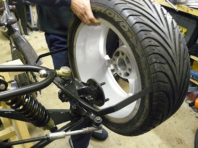

One comment - looking at your front suspension assembbly pic, it looks like the top wishbone maybe fitted upside down. I'm not overly familiar with the Dax chasis/bones, but most other kits have the top ball joint angled up instead of down.
Also, the lock nut on the ball joint is usually on the outside of the wishbone. Again, this maybe different for the Dax set-up.

Ta Nick, I should have shown you that pic earlier . In the blurb underneath the picture I explain how the setup is wrong and was leading to restriction issues.. finally worked out the wishbones were on funny when a friend pointed them out!
There is only one nut on the top wishbone ball joint, which is locking and cannot be in a different position (as the joint would fall out!) am I missing something - feel free to point out some idiocy!

Is the top wishbone threaded internally to take the ball joint?
Gernerally the bone is threaded so you screw fit the lock nut to the ball joint then screw the joint into the bone and tighten the lock nut against the outside of the bone.
Some bones are unthreaded to alow for camber adjuster setups like the GTS ones.

Ah no, the top wishbone isnt threaded its just interference fit with a nylon locking nut on the end of the ball joint.
On either side of the wishbone mounting hole there are 5 shim washers which are used to adjust the camber. Its not clear in the picture, so I'll take some more later for the benefit of anybody else who views this section. (Could do with a "correct setup" picture anyway!). Thanks for pointing that at though, if the bone had been threaded then that would have made a silly error by the time it was on the ground!
