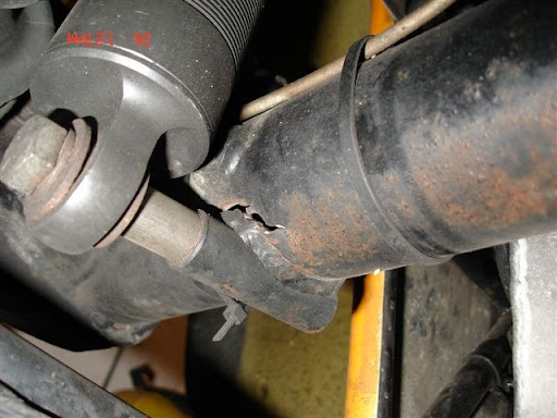

Seems some cat owners are having dedion head aches
http://picasaweb.google.co.uk/helluvaname/DedionFailureInfo#5211786129997119826
http://213-04.com/t.asp?id=94283&pn=6&ps=15#1503342

looking at those photos, it look slike just about every weld failed. i wonder if he's actually hit something linstead...

Oh yes very poor , What no gussets! those plonkers.

Tut tut bolt in single shear as well not good practice.. Not surprised it went like that at the weld boundary lots of stress at that point..

To be fare though looks like they revised the design a lot, also when it fails it looks like it still stays in one bit witch is helpful!!

I think thats the old design. They had a few failures years ago so revised the design. If yours failed it got fixed free of charge.

In the land of garage queens I wonder how many are still in circulation? My bet would be a fair few.
A lot of these cars are getting bigger power installed and the dedion is the last thing you want to go wrong. Steering from the rear is not fun as some of us have found
